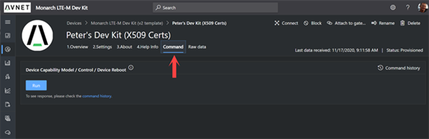

10. Dashboard Control of the Dev Kit Hardware.
  • Settings Dashboard View.
  • Command Dashboard View.

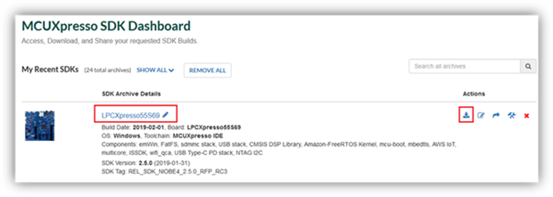

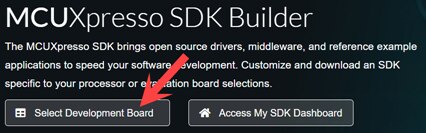

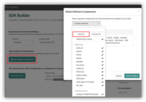

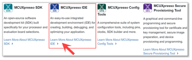

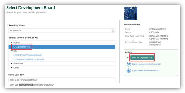

Appendix: Installation of NXP Tools (SDK and IDE)
  • Install LPCXpresso55S69 SDK (v2.8.x or later)
  • Install MCUXpresso IDE (11.2.x or later)

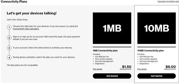

2) Verizon ThingSpace dataplan subscription (must be activated!)
     https://thingspace.verizon.com/iot-marketplace/

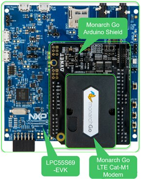

1. Hardware Setup
On the LPC55S69-EVK board, the default settings should be used.
Check specifically on the items listed below…
Make sure that:
   P4 jumper is set to 3.3V
J4 jumper for DFU is removed.
P6 microUSB connector (labeled “Debug Link”) is used
for the connection between dev kit and your computer

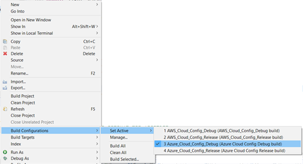

Set active build configuration to: Azure_Cloud_ Config_Debug

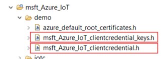

    Edit two files in: msft_Azure_IoT
    /demo

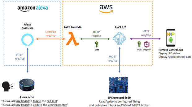

Simple touchscreen UI (Android phone App)
AWS
Accelerometer telemetry, Control RGB LED outputs
Set active build configuration to: AWS_Cloud_ Config_Debug
  1. X.509 certificates
    Edit two files in: freertos/demos
    /include
Voice UI (Amazon Alexa device or phone App)
Alexa custom skills for UI

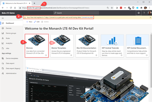

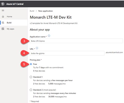

Setup IoT Central and Install Application from Provided Template
1) If not yet registered for an Azure account, then you will need to go here to register:
     https://azure.microsoft.com/en-us/free/
2) Open the Monarch LTE-M Dev Kit application template from here:
     http://avnet.me/monarch-devkit-IOTC-TEMPLATE
3) Enter a unique application name (preferably descriptive but keep this concise)
4) First section of your dashboard URL will be auto-generated from the application name.
     If a different URL is required you may edit this (but only lower-case and hyphens, no underscores)
5) Select the Free pricing plan (and check that you selected correctly!)
6) Fill in remainder of the form details then click the blue Create button at bottom of the page
7) Note the address of the “Welcome” dashboard that then opens. This page can simply be accessed and shared (provided additional users are authorized) using the first part of this URL. eg. in this case:
     https://bobs-lte-gizmo.azureiotcentral.com
8) Note also the warning that your “free trial” (for this application instance) will expire in 7-days
9) Click on the Devices tile to proceed to the creation of a simulation device and then a real device…

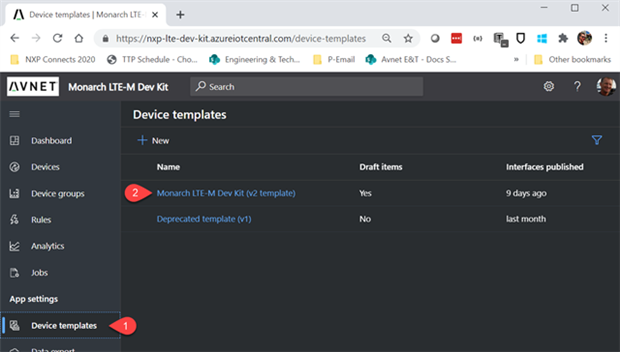

10)For future reference (do not click this now), clicking the Device Templates tile takes you to a listing of  application templates (which you can further customize if you need to) directly from this landing page by The left sidebar         however is typically what you will use to navigate to the different pages and views
(11)Notes:
      - The navigation sidebar is collapsed or expanded by clicking on the icon at top of this sidebar)
      - Return to this Welcome dashboard at any time by clicking on Dashboard at top of this sidebar
      - Dev Kit Documentation, IoT Central Tutorials and IoT Central Documentation can also be accessed from this Welcome page by clicking on those tiles

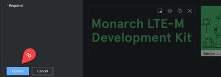

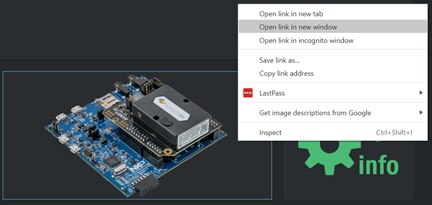

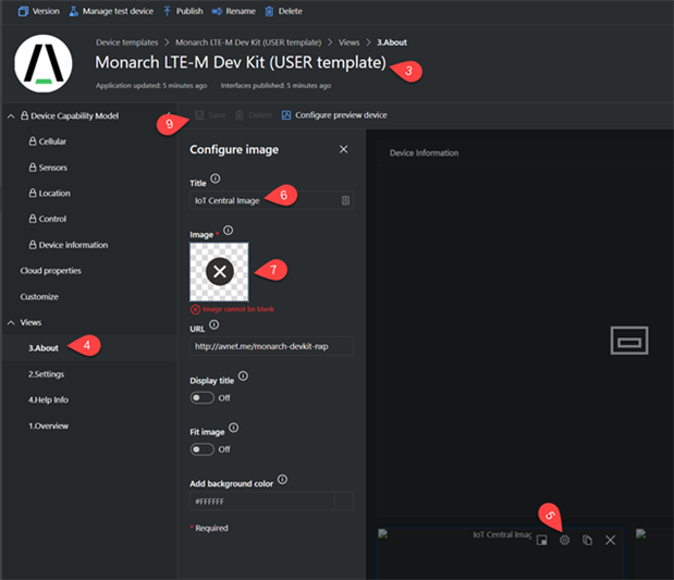

12)  Important! The provided dashboard template was
      designed to use  the “Dark Theme” display mode

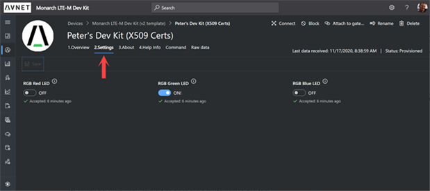

      Configure this setting by clicking the “Settings” icon
      located at top-right of status bar at top of the screen

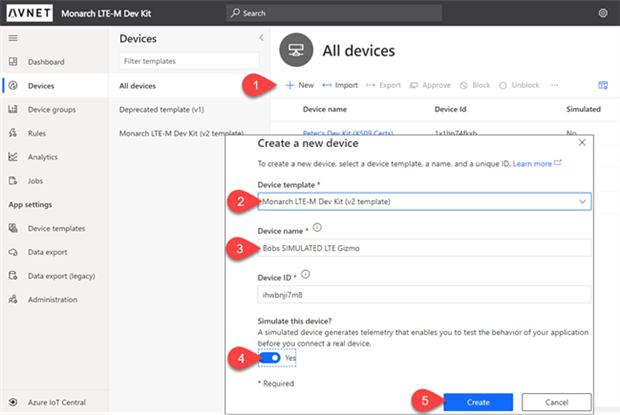

For a quick test of the provided template, it is recommended that you create and exercise a simulated device. IoT Central includes built-in ability to simulate IoT client devices to send telemetry to your dashboard
1) Go to the Devices section, then Click on +New to create a simulated device
2) In the form that opens, select the Avnet-provided Device Template
3) Specify a unique Device Name of your choice, then
4) Select Yes for Simulate the Device?
5) Click on the blue Create button

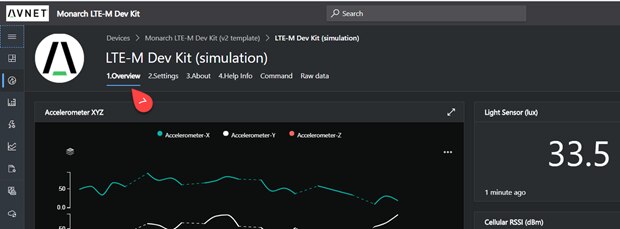

6) After a couple of seconds the new device will show-up as a simulated device under the listed devices

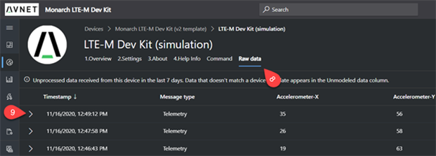

7) Click on this new device, select Overview and then wait for the simulated telemetry to start appearing on the dashboard…
Tip: Screenshots from here onwards show use of the “dark theme” display mode recommended earlier

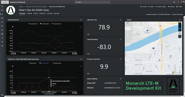

8) Next, select the Raw Data view, to inspect the simulated incoming telemetry messages
9) Click on one of the telemetry messages to inspect it’s contents

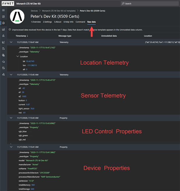

      A vertical listing of all the telemetry fields will display
      A horizontal listing of the modeled data fields can be scrolled through using the arrow keys
(When this view is used later for inspecting telemetry from a real device, any received telemetry that is not yet modeled in the dashboard, will get displayed as JSON text)

1) As done with simulated device, from the Devices section, click on +New to create a device
2) Complete the form as before, using a new Device Name.
3) This time select No Select Yes for Simulate the Device?
4) The new device will show-up as a non-simulated device under the listed devices
5. Setup Verizon ThingSpace IoT Dataplan
Before making edits and building the MCU application, it is recommended that you complete the set-up of your Verizon ThingSpace IoT dataplan.
1)    Go to https://thingspace.verizon.com/iot-marketplace/ where you will need to complete these steps:
     a) Select a connectivity plan (choose one of the six listed monthly plans)
     b) Sign-up for a Developer Connectivity Account and pay for selected plan with a credit card
     c)     Activate your Verizon-certified Monarch LTE-M device
2)    Use the ICCID and IMEI details from the label on your Monarch Go modem when activating this device in your ThingSpace account

Set the Build Configuration to target Azure
It is critically important that the active build configuration be set correctly!
Right-click on the project name and set this as shown below…

1) In your MCU application, navigate to msft_Azure_IoT\demo section then open the
msft_Azure_IoT_clientcredential.h header file
2) Edit line #22, adding the Azure DPS provisioning service as the MQTT Broker Endpoint
     "global.azure-devices-provisioning.net"

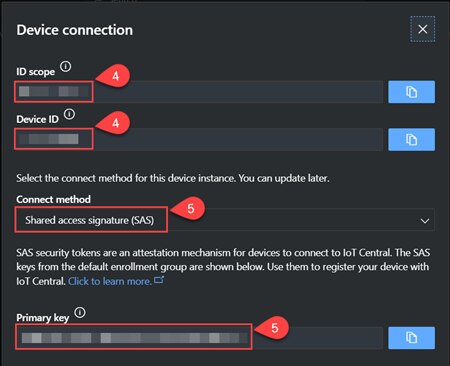

3) In your Azure IoT Central application, select your real device,
then click on Connect to open the Device Connection dialog.
4) Copy the Scope ID (ID Scope) and Device ID values to the header file
     #define clientcredentialAZURE_MQTT_BROKER_ENDPOINT  "global.azure-devices-provisioning.net"
     #define clientcredentialAZURE_IOT_SCOPE_ID ""
     #define clientcredentialAZURE_IOT_DEVICE_ID ""
5) This application also includes some code to support the simpler Shared Access Signature (SAS) authentication. This requires SAS Primary Key for connecting your real device also needs to be added. While still in this Device      Connection window, click on Shared Access Signature (SAS) then copy to the clipboard the Primary key that is displayed…
6) Back in MCUXpresso, under the msft_Azure_IoT\demo section that you accessed before, open  msft_Azure_IoT_clientcredential_keys.h and edit line 14, adding the SAS Primary Key that you have just copied from the      Azure IoT Central application
     #define keyDEVICE_SAS_PRIMARY_KEY       ""
8) Save after checking the edits you made in msft_Azure_IoT_clientcredential_keys.h

Overview Dashboard View
Click on the Overview tab to access this dashboard view
As you did previously with the simulated device, examine the Overview followed by the Raw Data views. Telemetry data will start appearing in these views a couple of seconds after starting the debugger
Notes:
Functionality underlying some of the following dashboard widgets has not yet been implemented in the initial release of the embedded application. In these cases, simulation telemetry or constant values are sent in their telemetry data fields (eg. Light Sensor, Current and Button-Press).
The map tile at present displays the location defined by coordinates in the embedded code, but in later release this will be replaced by location data supplied by the Verizon ThingSpace Location API)
Update rate for the dashboard visualization is around once every 10 seconds
Update rate for the telemetry transmission is initially at 1 minute (set to PT0H0M10S in ISO8601 notation)
(Telemetry Interval is reported in the About dashboard view)

Raw Data Dashboard View
Click on the Raw Data tab to access this dashboard view
Open-up some of the messages in the Raw Data view. This will reveal the different types of messages that are being communicated between the Monarch LTE-M Dev Kit and the Azure cloud service
eg.

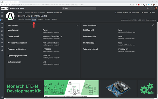

About Dashboard View
Click on the About tab to access this dashboard view
This reports static Device Information properties from the Dev Kit, as well as providing a passive view of the control settings that the dashboard has sent to the Dev Kit
Tip: Images displayed at lower edge of this window are clickable links which are best accessed using mouse right-click then “Open link in new window” (rather than lose presently selected dashboard view)

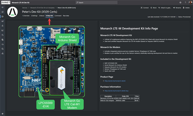

Help Info Dashboard View
Click on the Help Info tab to access this dashboard view
This view is informational only. It provides an example of how to embed sales and support information for operator (or customer) access while using your cloud-based IoT Central application
Work-around Required!
An issue encountered with export of the application template, requires that custom tiles containing images need to be edited (the image re-entered) in the version of template with which you are developing your cloud-based IoT Central application. This is simple to do and also provides opportunity for the developer to replace images and further customize their dashboards (This is discussed in more detail on next page)
Procedure to Replace a Tile Image Missing from Template
1) From the navigation sidebar, open the Device Templates view
2) Select the Monarch LTE-M Dev Kit (v2 template)
Procedure steps below, refer to the screenshot on next page:
3) Rename the template to a name of your choice (this auto-saves when you move to a different field)
4) Under Views, select the dashboard view that you wish to edit.
For this example select the About dashboard view
5) Click on the settings icon in one of the custom tiles that does not display it’s image correctly
6) This will open a “Configure Image” panel.
      Change the title of this tile (in dashboard use, the title is visible when mouse hovers over the tile)
7) Re-enter or replace the image used in this tile, by clicking on the Image field and then browsing to the image that needs to be inserted.
      You can also edit the URL that a mouse-click on this image will link to, by editing the URL field
8) Click on Update (to save the Tile edits)
9) Click on Save (to save the View edits)

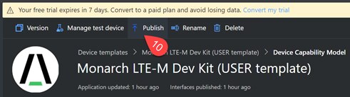

10)For this updated template to be deployed you need to “publish” it.
      When finished with all edits and the updated tiles and views have been saved, click on “publish” at top of the template window
Three slider switches are provided for remotely controlling the RGB LEDs on the Dev Kit hardware.
Note that the Save button at top of this view must be clicked to transmit the changes that you make to these slider switches!
Not currently supported by the MCU application, but the intention of this control is to support remote reboot of the Dev Kit application.

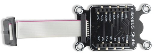

12. Hardware Expansion via Click Shuttle Interface
Support for MikroE Click boards is provided via an optional MikroE Shuttle Adapter. This inexpensive adapter ($8.00, p/n: MIKROE-2880) when attached to the Monarch LTE-M Shield, facilitates the use of MikroE Click boards from more than 900 different Click boards now available.
See the following webpages for more information (Avnet also stocks the MikroE boards)
https://www.mikroe.com/click
https://www.mikroe.com/mikrobus-shuttle
https://www.mikroe.com/mikrobus-shuttle-5pcs
1.     Open a web browser and navigate to the MCUXpresso homepage mcuxpresso.nxp.com
2.    Click on Select Development Board to download the LPCXpresso55S69 SDK with AWS component
3.     After being redirected to the nxp.com login page, enter your NXP account login info (or register for a new account)
4.    Back on the Select Development Board page, search for LPCXpresso55S69,
      Select it then click on Build MCUXpresso SDK
5.     At Select Optional Middleware section, click the + Add software component, a window will pop-up with a list of components, Select All then click Save Changes
6.     Select Download SDK
Note: You may see “Request to Build” instead, if this the case, then click on that.
7.     After the package gets built, there will be a new download in the SDK Dashboard section.
Click on the “Download SDK archive and documentation” button.
8.     Open mcuxpresso.nxp.com
9.     Select the Software and Tools tab, then
      click Learn More about MCUXpresso IDE
10.  Download and install the MCUXpresso IDE (11.2.x version or later)

    just a heads up it looks like NXP has dropped the AWS example from the 2.9 SDK.
