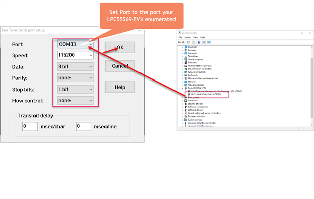

    To connect to a terminal do the following.
    1. Download / install Tera Term or another terminal program - https://ttssh2.osdn.jp/index.html.en
    2. Connect P6 (debug link) on lpc55s69-evk to your PC (this also powers the board)
    3. Open Tera Term
    4. Open Setup -> Serial Port
    5. Set the following accordingly and select ok
    Both x509 and SAS should work if you get the latest source code from github. SAS is a lot simpiler to setup/use for development in my opinion.
