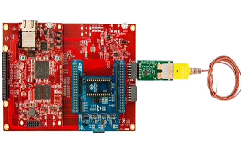

The MicroZed Industrial IoT Bundle is a development system built around the Xilinx Zynq-7000 All Programmable SoC. It includes dual-core ARM A9s, 1GB of DDR3 memory, 10/100/1000 Ethernet, and integrated FPGA fabric. The platform integrates with Amazon FreeRTOS to provide a powerful heterogenous Industrial IoT platform capable of executing mixed criticality applications such as complex motor control in the FPGA and IoT connectivity via the processing subsystem.
Documentation and Design Files
Top
Key Features
  • STMicroelectronics Sensor Shield includes
    • LSM6DS0: MEMS 3D accelerometer (±2/±4/±8 g) + 3D gyroscope (±245/±500/±2000 dps)
    • LIS3MDL: MEMS 3D magnetometer (±4/ ±8/ ±12/ 16 gauss)
    • LPS25HB*: MEMS pressure sensor, 260-1260 hPa absolute digital output barometer
    • HTS221: capacitive digital relative humidity and temperature
    • DIL 24-pin socket available for additional MEMS adapters and other sensors (UV index)
  • Maxim Integrated Thermocouple Sensor
    • Converts Output of a K-Type Thermocouple Directly to a Signed 14-Bit Digital Word
    • Cold-Junction Compensation
    • 14-Bit, 0.25°C Resolution
    • Detects Thermocouple Shorts to GND or VCC
    • Detects Open Thermocouple
    • 6-Pin Pmod-Compatible Connector (SPI)
  • Production ready, MidcroZed 7010 SOM
    • Based on Xilinx Zynq-7000 SoC
    • Dual ARMCopyright CortexTm-A9 processing system
    • FPGA logic
  • Expandable development platform
    • R3 Arduino-compatible shield expansion slot
    • Two 2x6 peripheral module expansion slots
    • Additional user header providing access to SPI, I2C, UART, and GPIO on MicroZe
  • Pluggable sensor options
    • ST Microelectronics motion MEMS and environmental sensor shield
    • Connects to shield site
    • Six I2C based sensor solutions
    • 3-axis accelerometer + 3-axis gyroscope
    • 3-axis magnetometer
    • Humidity and temperature
    • Pressure
  • Connectivity
    • 10/100/1000 Ethernet Port
    • Optional WILINK8 WiFi/BLE add-on
