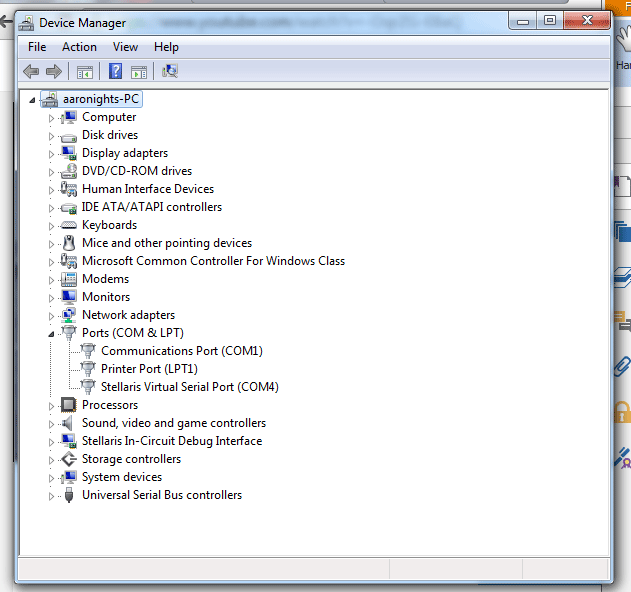

Before you can begin programming the Launchpad you'll need the drivers installed. The best way to get these installed is by downloading TivaWare. This also contains a suite of software, examples and tools to help with developing on a Tiva C series Launchpad and its various BoosterPacks. You'll need to install multiple drivers for things like the In-Circuit Debug Interface and for the Virtual COM port to enable terminal access to the Launchpad through a Windows program like Putty.
Tip - The virtual COM port number your Launchpad gets assigned will be different depending on how your PC is configured. To find out what number it has been assigned, open Device Manager and look under Ports for something named 'VirtualSerialPort'. If you've just installed the drivers the Launchpad will most likely be the device with the highest COM port number.

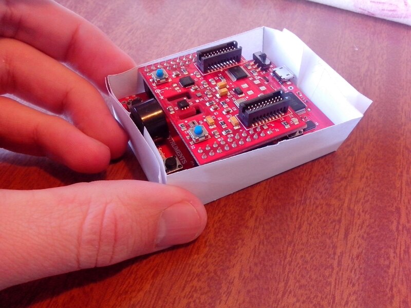

For my project using the Launchpad, I opted to use Energia to code it. Libraries for everything on the Sensor Hub Boosterpack aren't available by default, but the TMP006 temperature sensor libraries are pre installed courtesy of Adafruit. The project is a simple temperature alarm, involving connecting a buzzer to the Launchpad and sounding it when a certain temperature is reached. Because I have an old mechanical gas heating in my house, if I fall asleep late at night with the heating set to maximum I sometimes wake up hours later sweating from the heat. This alarm will ensure that I'll be notified before the room temperature gets out of control. I also set up one of the buttons on the Launchpad to disable the alarm for 20 minutes so it wasn't constantly sounding while waiting for the temperature to lower.
I used male-female jumper wires connected to the sockets on the bottom of the Launchpad to attach a cheap piezo buzzer . When doing this, be sure to look up the documentation for any BoosterPacks you are using to make sure you don't have any pin conflicts. After researching I opted to use pin 40 to power the buzzer and pin 20 for ground, following the Energia pin numbering schematic.
The Launchpad is primarily for development and prototyping, but to give it a bit of protection while using it in a more permanent project like this I wanted a case. I made a initial mock up out of paper to get the measurements correct before using thick stock card for the final.
Lightly scoring the back of the card where the folds are gives a cleaner finish. Because the microUSB ports on the Launchpad extend out slightly from the edge of the board they are able to help hold it in place. Given the BoosterPack has light and temperature sensors, putting a top onto the case isn't a practical idea. Using a hard setting glue to adhere the tabs in place gives the structure more rigidity. I bent the pins on the jumper cables for the buzzer to a right angle, connected them to the bottom of the board then looped them around. The buzzer was mounted to the front of the case between the reset button and debug USB port on the Launchpad.
