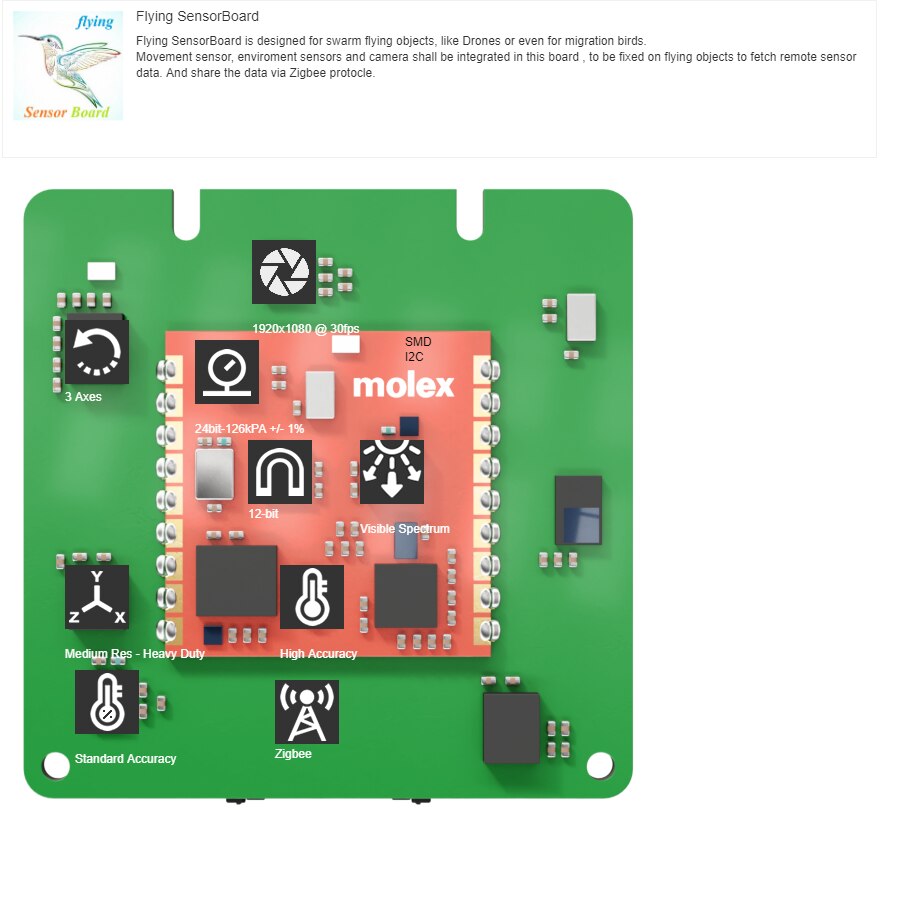

Flying sensorboard is designed to be fixed on flying objects to sensing movements, remote visual, and remote environment.

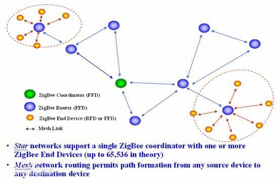

The most fascinating part of this board is the application on Swarm Flying objects, such a flock of birds, when Zigbee is configurated as Mesh Grid in adHoc state. That means each bird can join or leave the moving Zigbee Mesh freely. In open air, 2.4GHz Zigbee can provide reliable links ranging 100 meters.
There are three groups of sensors on this flying sensor board,
Movement sensors:
  • Magnetometer
  • Gyroscope 3 Axes
  • Accelerometer Medium Res - Heavy Duty Medium Resolution  (12 bit)
Environment sensors:
  • Temperature
  • Pressure-24bit-126kPA
  • Humidity- 0 to 100% R
  • Light -Visible Spectrum (peak wavelength 750nm)
Visual sensors:
  • Camera 1920x1080 @ 30fps Streaming Video (30 fps)
One I2C bus is provided for further extension for more sensors.

Flying sensorboard is designed to be fixed on flying objects to sensing movements.
  • Pressure                    High Resolution (24 bit) + High Pressure (126 kPa) + Standard Accuracy (± 1.0%)   for  altitude sensing
  • Magnetometer            Medium Resolution (12 bit) for magnetic direction  in navigation
  • Gyroscope                  3 Axes - Eg. Pitch / Yaw / Rotation for movement sensing
  • Camera                       Streaming Video (30 fps) + Hi-Definition  (1920 x 1080)  for visual imaging
  • Accelerometer             Medium Resolution  (12 bit) + Heavy Duty  (± 90.0 G)  for movement sensing
  • Humidity                      Standard Accuracy (± 5.0%) from 0 to 100% RH  for environment index sensing
  • Light                             Visible spectrum (peak wavelength 750nm)  for environment index sensing
  • Temperature                High Accuracy (±0.5°C) from -40°C to 105°C  for environment index sensing

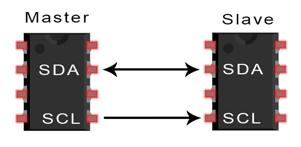

  • Hardwire I2C bus interface bus,
With standard 100 kbit per second and 400 kbit fastmode or high speed 3.4 Mbit option , I2C is not only used on single boards but also to connect components which are linked via cable. Simplicity and flexibility are key characteristics that make this bus attractive to many applications. I2C is a true multi-master bus providing arbitration and collision detection.
  • wireless  Zigbee
Principle of Zigbee can be shown below as reference, this robust protocle makes the board fly with birds.
