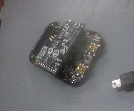

A few months ago, Element14 sent me an XTRINSIC-SENSORS-EVKXTRINSIC-SENSORS-EVK kit to play with.  This is an MBED compatible evaluation board which includes an ARM processor, some new freescale sensors (MMA8491Q Accelerometer, MAG3110 Magnetometer and a MPL3115A2 pressure sensor), a capacitive touch panel, and an RGB LED. It is available from farnell for the bargain price of £19 including vat.
I plugged it into my main PC running Debian, but the MBED drive wouldn't show up so I couldn't use it.  I then tried it in my old macbook pro and had the same issue.  Then I decided to give up, and put it in a drawer somewhere.  I dug it out this evening to finally figure out what I was doing wrong, and have another go at getting it working.
After a bit of searching around, I couldn't find much information on the Sensors EVK itself, so I broke it down into its constituent parts, an XTRINSIC-SENSORS board that holds the sensors, and the Freescale FRDM-KL25Z microcontroller board, and googled the microcontroller board itself.
Victory!
After a bit of googling, I found this page, which has a section about how MBED have a new firmware out for the FRDM-KL25Z!
Its a pretty easy process to upgrade the bootloader, though you will have to hold your nose and borrow your grandma's windows computer to perform it!
  • Press and hold the button in between the two USB ports with both the USB ports unplugged
  • Plug a Mini USB cable into the USB port labelled SDA (its the one next to the little 10 pin connector
  • You should get a USB drive show up called BOOTLOADER.  For some reason this wont enumerate properly using Linux or Mac, which is why you have to use windows for this step
  • Let go of the USB port
  • Download the new bootloader file from http://mbed.org/media/uploads/sam_grove/20140530_k20dx128_kl25z_if_opensda.s19
  • Put the file onto the USB drive
  • Once it has finished copying, unplug it and plug it into your real computer
  • Hurrah, you now have a drive called MBED!
