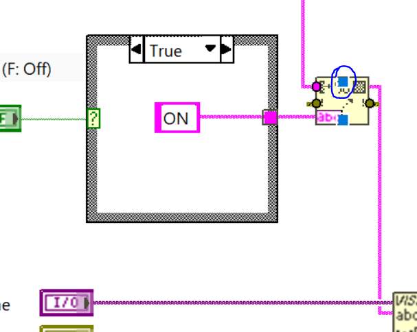

I am trying to create a labview driver for controlling the pi pico led. I went through the Digital Out Control.vi VI in pico_scpi_usbtmc_labtool and tried to replicate it for the led control. I took the blink example from pico-sdk examples directory and added the function to control led (i.e. gpio_put(LED_PIN, 1)) to the SCPI_DigitalOutput() function of gpio_utils.c file in pico_scpi_usbtmc_labtool. I created a new firmware with this change and loaded on pi pico. Now, whenever I do digital write HIGH, the led is turning on.
But when I tried to create a separate driver for led control with a separate SCPI command, I am getting some error while running the VI. The build was successful with my change and I loaded the firmware on the pico, but when I am trying to run my VI (snip attached below), I am getting the below error.

    This is failing in the init code, so it’s not even reaching your code. One of the installed tools with LabVIEW is NI I/O Trace. Run that, turn on tracing, then run the VI again and see if that gives you…

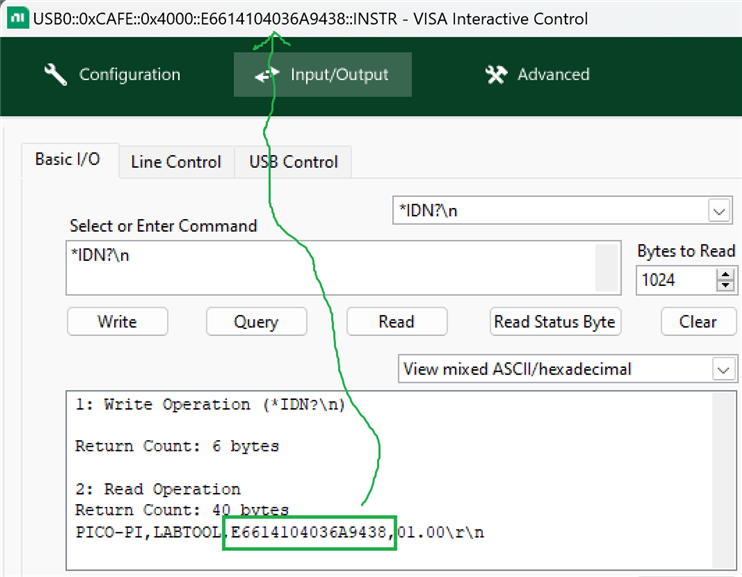

    Jan Cumps over 3 years ago in reply to Andrew J +2
    The init block indeed checks for the IDN* string I haven't exposed the connectors to the button that can turn ID Check off. You can do this yourself, by clicking on the connector location in the…

    0 Jan Cumps over 3 years ago in reply to Andrew J
    You can do this yourself, by clicking on the connector location in the Icon, then selecting the control
    If you write firmware with a different ID string, you should also create a driver and  adapt that Init block to your ID:
    I'll take care that the PST driver is updated to exposes these 2 connecters (set as  optional):
    (side note):
    In the next version, the *IDN? will have the unique pico id:
    The LabVIEW driver checks the first two partameters only, so it's backward compatible (and I tested it Slight smile)
