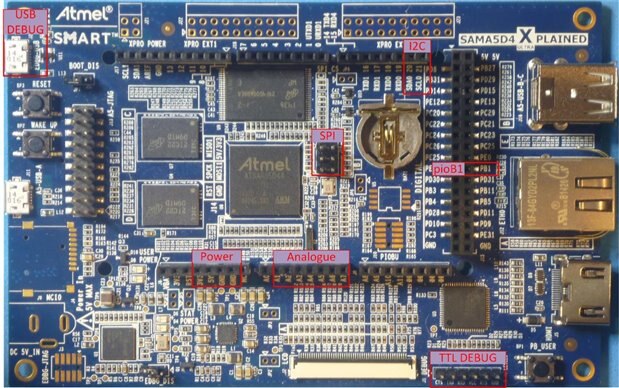

Note there are 5 analog input channels in_voltage0 - in_voltage4 these are NOT mapped to pins A0 – A4 but instead are mapped to pins A1 – A5

in_voltage0_raw --> PIN A1 on the board
in_voltage1_raw --> PIN A2 on the board

now as some pins are already defined by the OS for their operation, you will find that even though the command seems to work, it wont show up on the expected pins
This one however proved to work without an issue
echo 33 > /sys/class/gpio/export results in pioB1
this pin is identified in the diagram above
