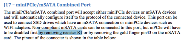

But for some reason, mine booted directly off the USB stick. I didn't realise it at that moment, so I proceeded with the Ubuntu installation wizard. Only briefly though, as it was stating there was not enough space to install. For some reason, the SSD was not detected. Why?
I started going through the user guide again, thinking I might have to do something to switch between miniPCIe or mSATA mode and found the following:
Should I conclude my SSD is non-compliant ?
Modification
In an attempt to get my SSD detected, I decided to go ahead and remove resistor "R1". The resistor is clearly indicated on the board with a white arrow pointing to it.

With the resistor removed, I booted the Gizmo2 keeping my fingers crossed while pressing "F12". And there it was ... the SSD was detected!
Using the installation wizard, Ubuntu was installed successfully on the SSD and I was able to boot from it (unlike the microSD card). Hooray!

  • to have a little jumper to enable/disable resistor "R1" instead of having to solder/desolder it
