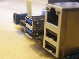

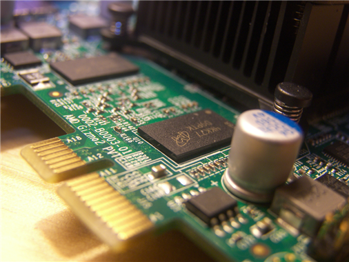

The new Gizmo II from Gizmosphere is absolutely oozing with power:image
  • dual-core 64-bit AMD SoC Jaguar II processor, with built-in GPU
  • 1GB of DDR3L RAM; on-board USB3.0 ports
  • a PCI-Express card slot
  • HDMI out; gigabit Ethernet

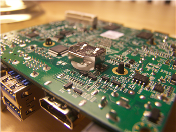

  • And, as a bonus, a real-time clock that is battery-backed, something sorely lacking on many other single-board computers out there.
You may think from the specs that it's a modern computer – it's hard to believe that Gizmosphere have managed to pack so much into something the size of a slice of bread.
