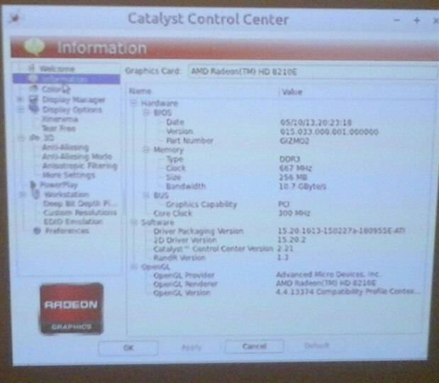

    And so I did. The log said I had some dependencies missing and explained how to install them.
    Oddly I had to repeat this several times as each time the log mentioned new dependencies I was missing.
    In the end I got the installer, waited for 20 minutes and did "aticonfig --initial" as the guide said.
    But after rebooting Ubuntu is in "limited graphics mode" and I can't see what it's says because of how small the texts are.
    I think it says "What would you like to do" and there are 4 options. Mouse is not working...
    EDIT: Okay, I'm back to step 1. I uninstalled the proprietary driver and could go to the usual desktop again. How to recover from 14.04 fglrx driver install failure? - Ask Ubuntu
    However, I still don't have the driver for my OpenGL program to run faster and the whole system is slow, with 90%+ of CPU taken by default.
    Not to mention, now I'm greeted with a very vague ''an error has happened'' message each time, forcing me to reinstall the OS.
    See, this is why I wanted Windows to work...
    I used a normal logitech mouse, it worked fine. Could you try an alternate mouse (perhaps a wired one if you're currently using a wireless one), and also do you have anything else plugged in that could have high current draw causing (say) power supply issues? This is just a guess though - there could also be some hardware fault I suppose. A different USB socket should eliminate that but I'm sure you've already tried that.
    With the driver uninstalled, there will be no acceleration and part of the CPU consumption may be due to that. There is usually a README or INSTALL file or some other documentation with the driver that may provide the answer, but otherwise all I can suggest is to examine the log file mentioned earlier and try to resolve the messages that appear there. It is a good 20 minutes or more delay while it gets installed, and should not be aborted.
    Regarding the 90% CPU thing, there are Linux tools that could help, e.g. 'top' and 'ps' to examine what processes are running and what is hogging CPU. Without using them, it is just guesswork I'm afraid : (
    There may be a log in /var/log or a subfolder, it is worth checking to see which file was last modified in that folder, and seeing if some more useful error message was appended to a file there.
    Certainly more of the community will have experience with Linux on Gizmo 2 than Windows, so if you need community support then on balance of probabilities you may get more of a response (hopefully useful, but not always the case since we're all fallible) if you go with Linux. If you use Windows, then probably you may need to do much more of the troubleshooting and problem-solving, or seek assistance from Gizmosphere or Microsoft or from some embedded systems consultancy, or Windows-related forums. I am not best-placed to suggest the optimum option (Linux or Windows or even some other platform), it is really down to you.

    0 Former Member over 10 years ago in reply to shabaz
    Nothing fast is connected to the Gizmo. In fact, only keyboard, mouse and the mSATA.
    OK, so this is what I did:
    1) Uninstalled, installed Lubuntu.
    2) Installed the proprietary GPU driver from the menu.
    Seems to run the OpenGL apps.
    typing ''fglrxinfo'' in the terminal gives this:
    [code]
    OpenGL vendor string: Advanced Micro Devices, Inc.
    OpenGL renderer string: AMD Radeon(TM) HD 8210E
    OpenGL version string: 4.4.13374 Compatibility Profile Context 15.20.1013
    [/code]
    Is there any reason to download the driver from the AMD site manually and do it the other way?
    It did work, but I dont know if its the correct driver or as optimized.
    Maybe comparing the output strings of ''fglrxinfo'' will answer that?
  • Former Member
    0 Former Member over 10 years ago in reply to Former Member
    Here's what it shows for me. Can you compare to yours?
