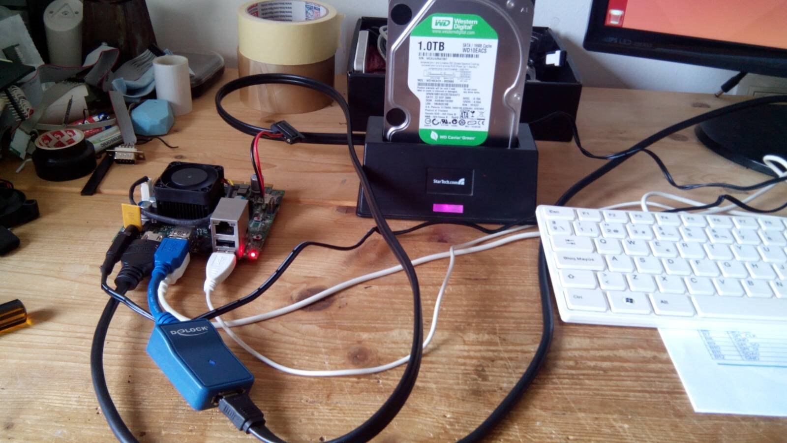

The machine external HDD machines will use the two USB3 Gizmo2 as dual raid hdd storage. USB3 has almost the same access speed than the SATA bus.
The machine will use eventually the external HDD connected to the on-board second sata port.
The machine is powered by a 4000 mA power supply giving the extra-power needed for the attached peripherals.

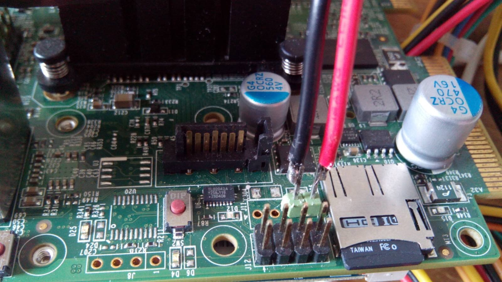

The second SATA connector and the SATA 5V power cables
Inside this scenario (if needed images are also available) I experience some issues that seems very probably hardware-dependent. What I need is some good check advices to verify for sure the issues causes.

For now it is used a 1Tb 5" 12V + 5V HDD externally powered that will be replaced in the definitive configuration with the specific hardware. The difference in this case is meaningless Two disks will be connected to the USB3 via a SATA to USB3 converter that reaches a comparable speed. The following image shows the HDD connected in this way with an external powered dock.

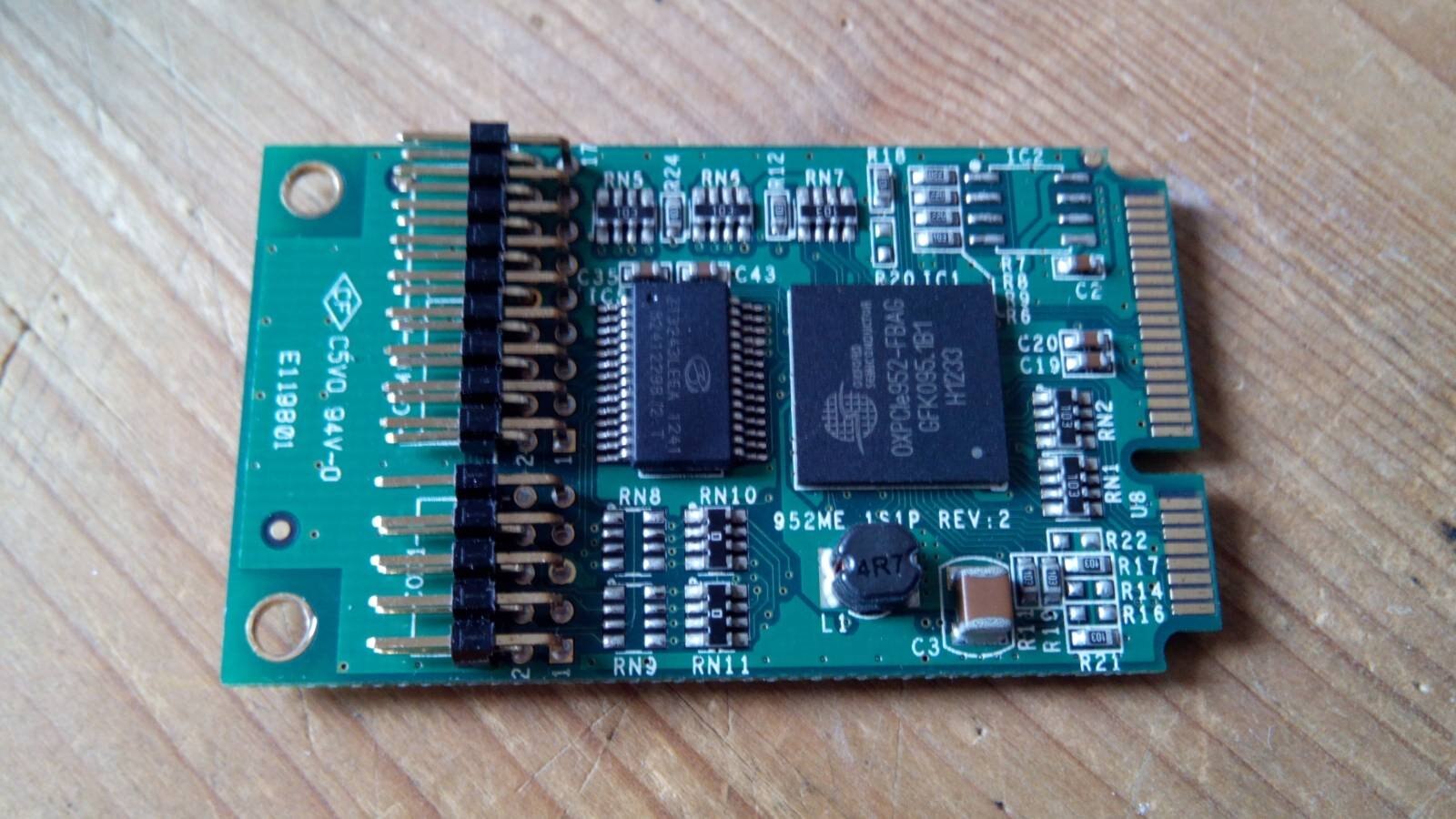

mPCIe board with Parallel + serial interface
This is a micro PCIe board that has the same connector as the micro SATA. The board should be installed in the Gizmo2 bottom connector; as explained in the documentation the system will recognise automatically if the connector is used for mPCIe or mSATA with SSD drive connected.

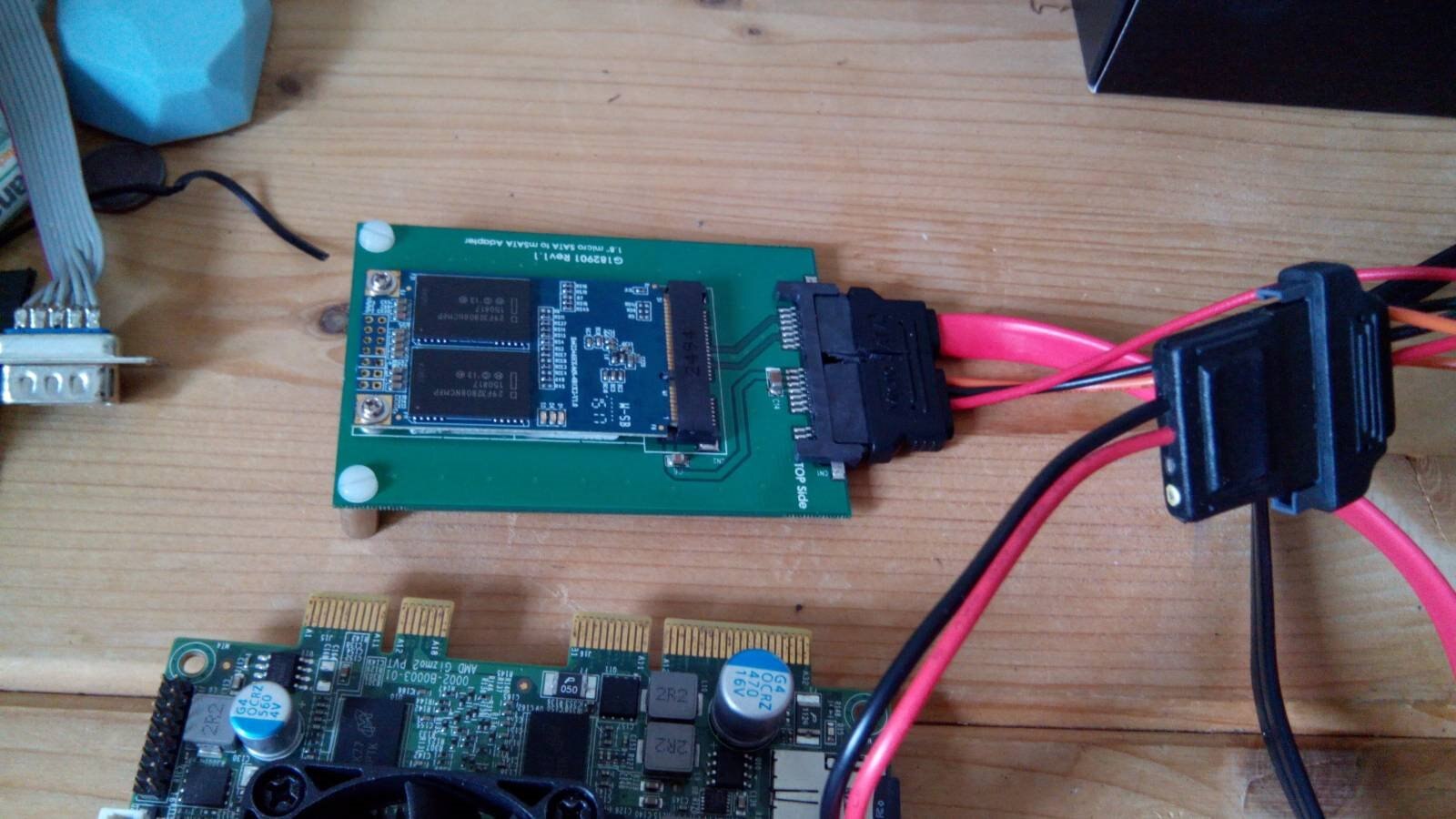

SSD disk starting from the secondary SATA
The secondary SATA should host the operating system when the primary SSD connector (on the back side of the Gizmo2) is used as microPCI instead of microSATA The image below shows the board mounted on the mSATA to SATA adapter board.

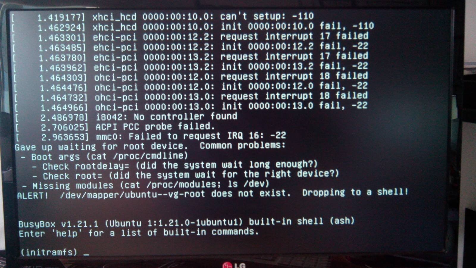

  1. Installing the OS on the microSD : all the installation process works fine with Ubuntu only, then at the end of process it is required the first reboot. The system boots and the only thing shown on the screen is "Booting from HD" then the system does not goes ahead.
  2. Installing the OS on the external HDD (both Debian and Ubutu): same as 1)
  3. The only way until now I was able to install Linux Ubuntu 14 was on the internal SSD (120 Gb) that boot fine after installation without any issue.

The second SATA port is on the board (thanks again to for her precious previous tests and shared knowledge !!!) and it is not populated. As the documentation explain it is a second port, we should expect that it can work with the first one connected. Instead:
A. With a 120Gb SSD on the first mSATA and any kind of SSD or HDD connected to the second SATA port as explained above none of the two disks are saw at boot time (only the micro SD if present).
B. With the mPCIe adapter (Serial + Parallel) in the primary port and the HDD on the SATA port, it is saw but does not work correctly. Instead with the SSD connected to the SATA (second port) it is not saw at all at boot time.
C. As the SSD or MPICEe boards are removed from the bottom connector, the SATA disk is saw correctly. Only the HDD can be connected and the operating system installed as well.
D. Only if the 120 Gb SSD is connected to the bottom port can be formatted and the operating system installed correctly.

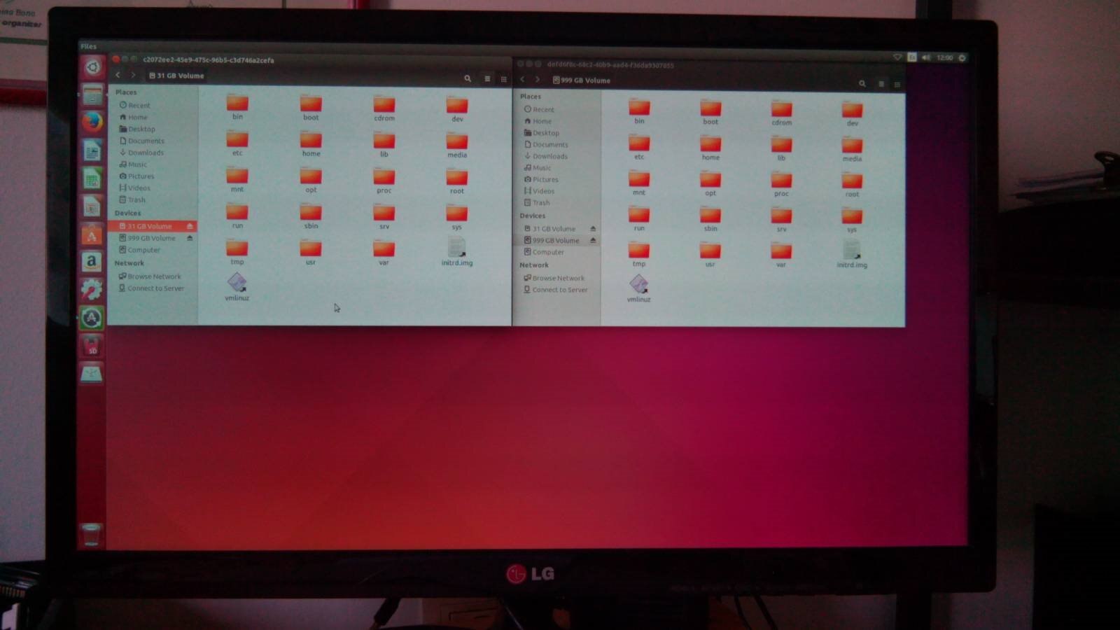

The same Linux OS has been installed with success on the external HDD (via the second SATA connection and external power), the microSD and the SSD (connected on the bottom connector). The only installation version that boots correctly is when the ssd is in its place and nothing else is connected to the system. The only accepted second HDD is when it is connected to the USB3 via the SATA to USB3 dock.
After booting from the Ubuntu desktop surprisingly all the linux installations on the three different media are virtually identical, despite that does not boot or boot partially, as shown in the images below:

The only possible bootable configuration is from the SSD on the bottom connector with the external HDD connected to the USB3 port.

    Try NOAPIC on boot line since that may be the problem.
    C
    0 balearicdynamics over 11 years ago in reply to clem57
    Hey Clem,
    thank you image How can I reach the boot line ? it seems there is no way, only F12 (when it work) on the SAGE boot screen to select the boot device.
