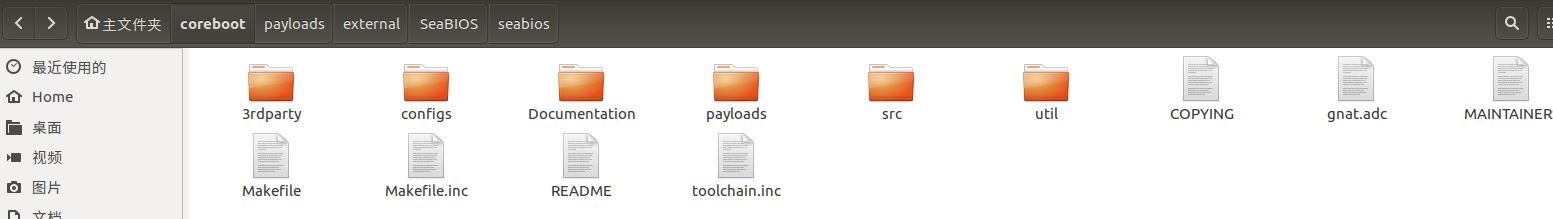

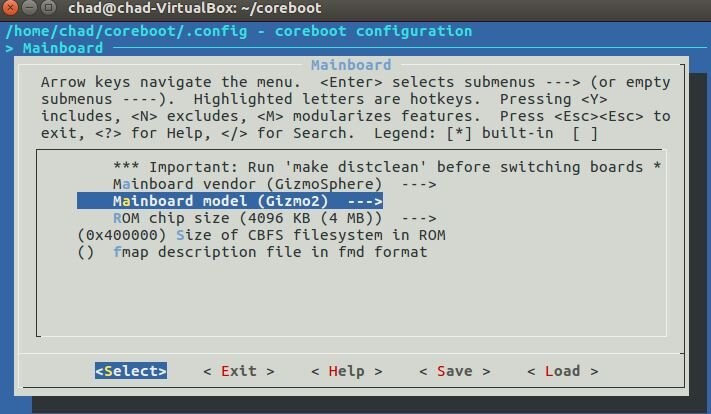

I get a board of Gizmo 2 form element. I want to build a bios.rom for booting. But I failed many times.image
my method is that:
1 I get the source code of coreboot
2 under the "coreboot",make menuconfig->mainborad->gizmosphere,gizmo 2

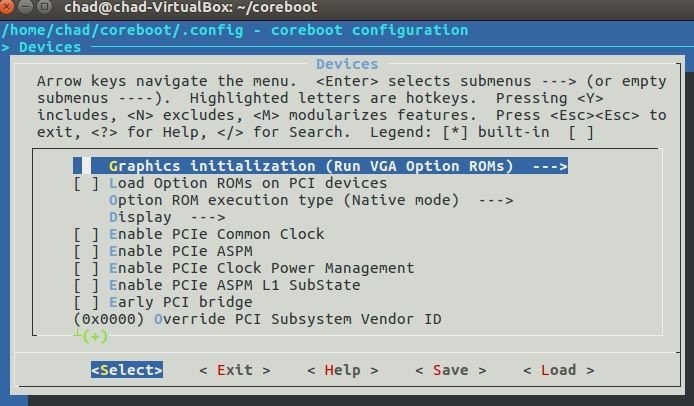

3 Deivces->Graphics initialization (Run VGA Option ROMs)

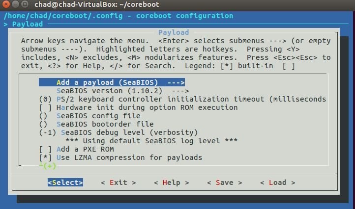

4 payload->Add a payload (SeaBIOS) ,SeaBIOS version (1.10.2)
5 make
I get the "coreboot.rom",and I dowmload it to the Gizmo 2,the Monitor is no picture,I don't know the bios is start-up or not?

    I detected that the led of SDcard is on. But the hdmi monitor is off. Maybe I lack the “Video BIOS” which enable display. I can‘t find it because the sage is down. and I also can't debug the board of gizmo 2
  • naugreem
    0 naugreem over 9 years ago in reply to edwardalick
    Hello, Jianbin Wu!
    You may extract video BIOS from original firmware.
    Instructions: https://www.coreboot.org/VGA_support
