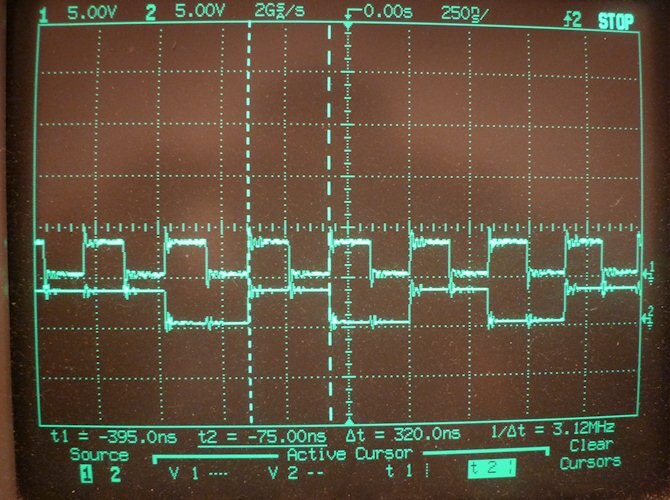

  • morgaine
    morgaine over 13 years ago in reply to shabaz
    That's really interesting, and your conclusion that it's working more by accident than by design does seem to be reasonable.
    Perhaps it  works only because MSB bits change more slowly than LSB ones in normal audio, and therefore although the data setup time isn't being met at the instant of change on any data bit, it's met for several subsequent sample periods on MSB data until the MSB data changes again.  As a result, the failure to meet the setup time is only detectable as LSB noise and so it's too many dB down to be heard by the ear when the audio signal has high dynamic range.  A possible explanation?
    For MSB bits, the effect of this 1-sampleperiod delay on each changing bit would mean phase distortion for each frequency component of the waveform of a magnitude proportional to its frequency.  I have absolutely no idea what this would sound like, some kind of timbre colouring I expect.  No idea whether it would be audible either.  Possibly not, since the phase would be delayed by less than 1/100th of a cycle for the standard A above Middle C (A4) pitch of 440Hz which is not a lot, and frequency contributions to an audio signal tend to fall off in amplitude with their frequency so the stronger phase distortion on higher frequency components would tend to be less audible.  Of course, the frequency components are present only in composite form so this is occurring statistically, which makes it very hard to predict the perceivable effect.
    Perhaps the effect could be modelled in Csound, but life's too short ...
    I wish we could attract Gerald Coley here for occasional comment on BBB design issues.

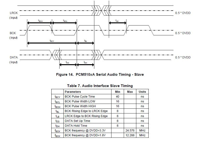

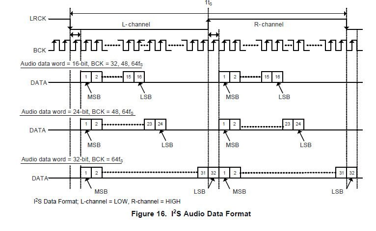

    shabaz over 13 years ago in reply to morgaine
    Thanks!
    I checked it out (pasted below). Looks like both ffmpeg and mplayer are pulling in shared libs that look the same for libavcodec, so possibly it is a bug in ffmpeg itself. I've been listening to music on-and-off all day using mplayer, and it's been performing consistently well.
    However, I think there is a bug in maybe the driver too, that was not noticeable:
    Basically, in some earlier tests with a logic analyzer I had thought the data was being clocked such that it had to be read on the falling edge of the bitclock. But, I2S requires the opposite. I thought I had made a mistake looking at the traces, but I just checked it again on a scope. The top trace is the bitclock (it is about 3.12MHz, so divided by 64 gives 48kHz sample rate). The bottom trace is the data, and you can see that it changes on the rising edge, so it must be intended to be read on the falling edge.
    Here is the I2S detail from the PCM5101 doc:
    So, the only thing I can conclude is that it is just lucky that the audio is playing, certainly the data set-up time is being violated. Either an inverter is needed, or the driver needs fixing.

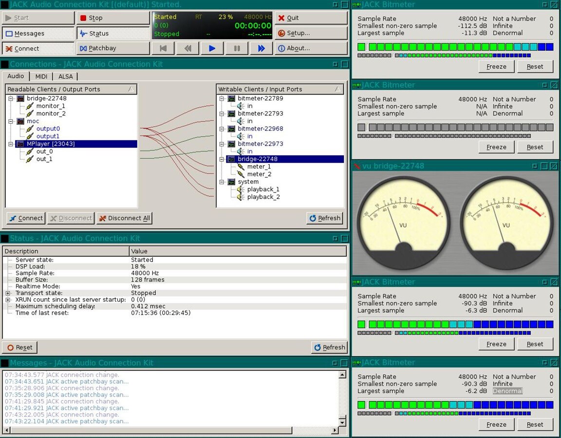

    e14 Contributor over 13 years ago in reply to shabaz
    shabaz wrote:
    There is no ldd on the BBB Angstrom build :-(
    I'd noticed that a few days ago while trying to work out why starting xterm caused all windows to lose their titles and borders. ldd is just a shell script, so it should be possible to borrow it from some other system. It's tiny as well, so I don't really understand why it's been removed.
    But this goes to Jonathan Garrishs post in the "Pi Forums" thread about wanting things to "just work", fine when they do, but when they don't and you find that the tools you use to work out what's going on have all been removed then you've already lost the battle.
    shabaz over 13 years ago in reply to e14 Contributor
    Hi Selsinork,
    You're spot on, ffmpeg is not built correctly, and a recompile is needed. I've spent the morning listening to some music on the BBB, and there is definitely an issue with ffmpeg, it has what sounds like faint clicks or short interruptions, plus it won't play 24-bit.
    The built-in mplayer doesn't suffer from these issues, and actually sounds superb. I've yet to check if it's truly 24-bit audio by inspecting the I2S stream. There is no ldd on the BBB Angstrom build :-( but I'm guessing mplayer has the libraries built-in rather than shared with whatever ffmpeg is using.
