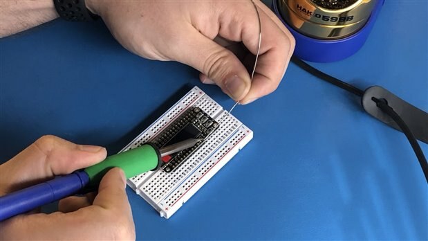

Step 1. Soldering the headers
Some of the FeatherWings in this project will require you to solder the header pins to the boards. To keep the headers square to the board. Place them in a spare breadboard, with the board you want to add pins to on top. This will help you'll get proper alignment as well as it's a lot more convenient to solder with the parts firmly in place.

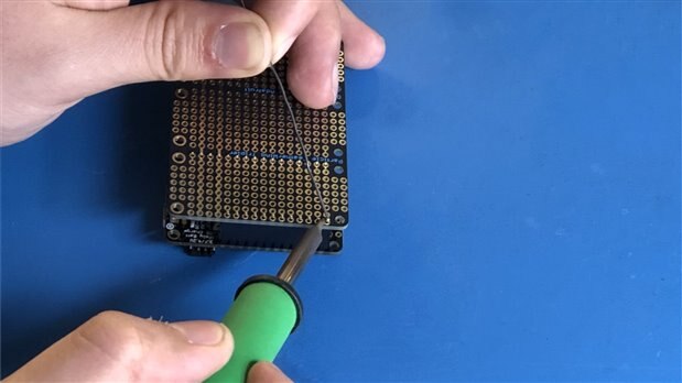

You'll need to solder the headers onto the Adafruit OLED FeatherWing. The FeatherWing Tripler uses female headers, but you can use a similar trick as you used with the breadboard. Place the female headers over their respective pins on one of the other FeatherWings, and then place them in the Tripler on top to solder. That way the headers will all line up correctly, and it's a lot easier to solder.
Attention: make sure you solder the Tripler correctly, or you risk damaging your boards.
Soldering the Tripler can be done without helping hands, but a steady hand is required.

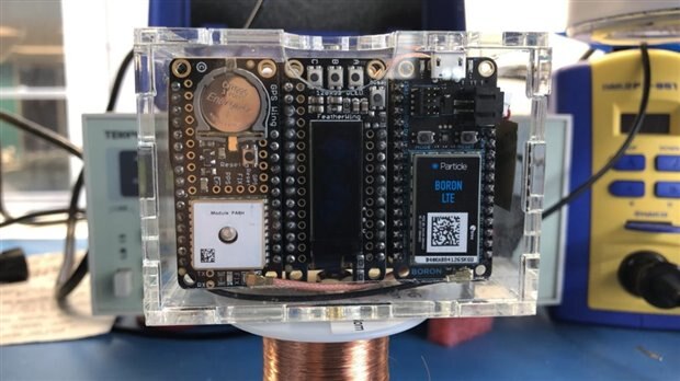

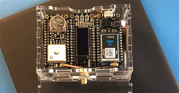

Step 2. Assembling your FeatherWings
With the soldering out of the way, you can move on to assembling the project. FeatherWing placement matters. In order to ensure access to the battery port on the Boron, you must place it on the right-hand side of the Tripler. In the middle comes the OLED Feather, and the GPS Wing will be on the left side.
Note: If you don't use this ordering, you'll have trouble routing the antenna and battery cables.
At this point, you can carefully attach the antennas to their respective connectors — make sure you use the cellular connector on the top side — and plug in the battery to the Boron.

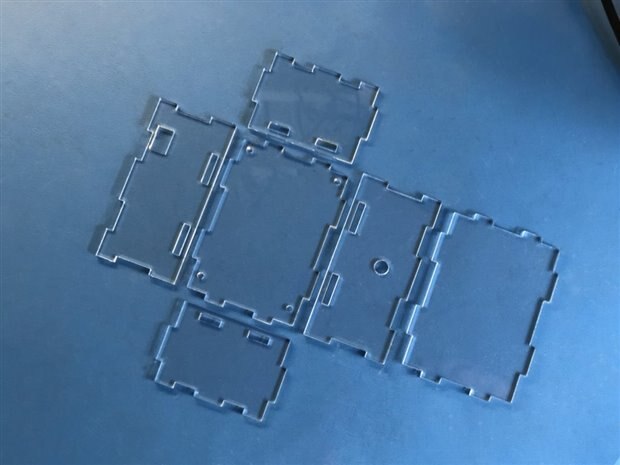

Step 3. Laser-cut your enclosure or build your own
If you've made or purchased an enclosure, you can start fitting the project in there now.

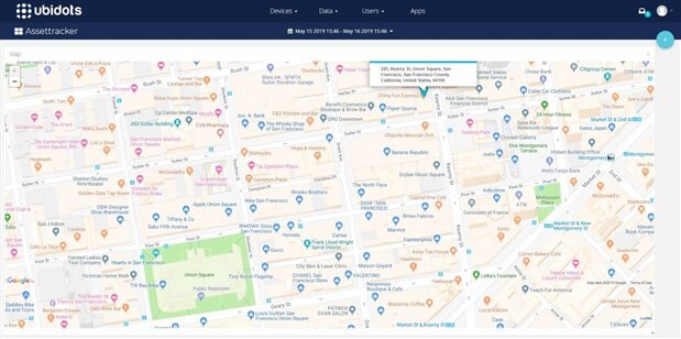

To take this project a step further than displaying the coordinates on the OLED, you can send the data to an online platform to display it on a map. There are various services available that offer functionality like this, such as the Particle Google Maps integration. For this tutorial, I chose to use Ubidots. They offer a great service for ingesting data and plotting it on a map. Plus it's easy to integrate. You can get the data to them by using a webhook in the Console, and a specific Particle.publish() on the device. First, create an account on Ubidots. For Ubidots to accept the data as a GPS location, it will look for a specific format in the data it receives. It expects to find a JSON object containing a lat and lng key, with their respective values.

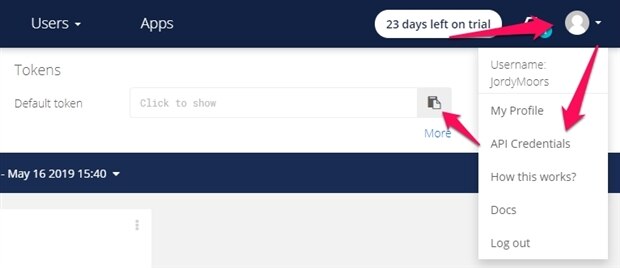

Make sure to replace the highlighted X-Auth-Token with your own. You can find said token by going to your Ubidots account, clicking on your profile icon and selecting API credentials.
After you've successfully completed each of the steps, you should now have a functioning cellular asset tracker that will display its GPS coordinates on the screen, as well as publish them to the cloud, where you can work with them in different ways to serve your purpose.

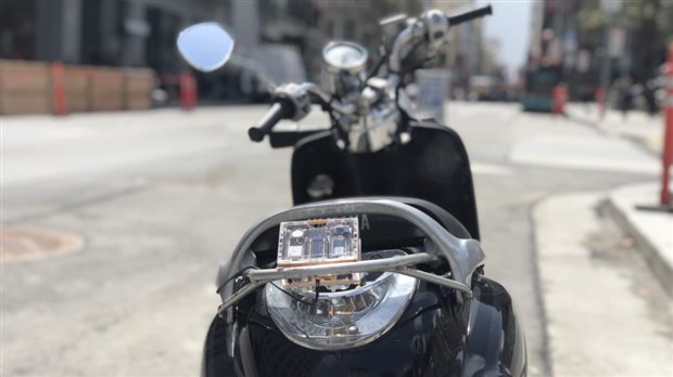

Starting with this project, you can use it as the basis of a car tracking system, a geofence for your pets or kids, track shipping containers or do something as mundane as making internet connected scooters. The possibilities are certainly there and so are the basics to start from.
