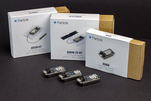

Roles describe the networking responsibility of a device
Roles define the network and routing responsibilities of a device in your Particle Mesh network, yet assigning a particular role does not limit the functionality of your Argon, Boron, or Xenon. Regardless of their role in the network, all three boards can run custom application code, interface with the peripherals like GPIO, and make Particle Cloud Primitive calls.
The quick approach to selecting a role
Determining the right role for an Argon, Boron, or Xenon is as straightforward as asking yourself what radios are available on each device.
Note: For now, you should exclude counting a Bluetooth radio, since its initial function in Particle Mesh is to provision a device not handle network traffic.
BoardsWi-FiCellularMesh
Argon✓✓
Boron✓✓
Xenon✓
