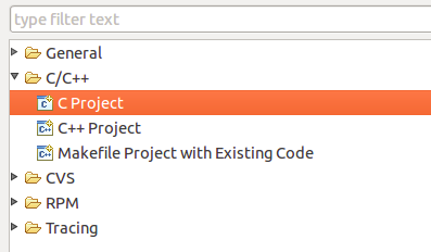

Click File > New > Project
Select C/C++ > C Project
Select Project Type > Executable > Empty Project.

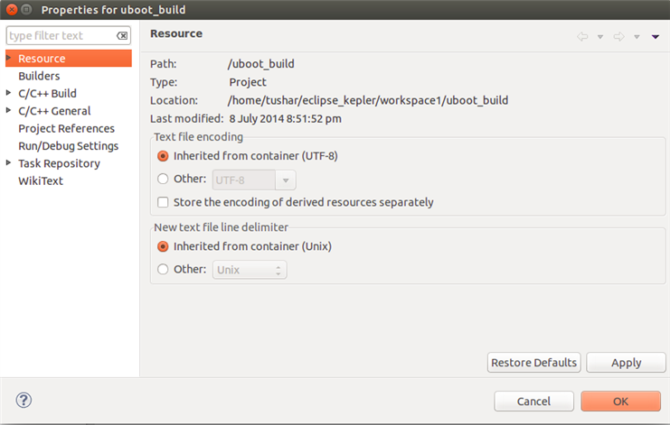

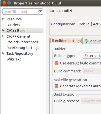

select Project > Properties on menubar or  hit {alt+enter} on keyboard to display the properties windows.
Highlight C/C++ build and select Builder settings
uncheck Generate Makefiles automatically.
Update the Build Directory with uboot source code path.
Select Behaviour
Empty the Build(incremental build) field.
Change clean to distclean

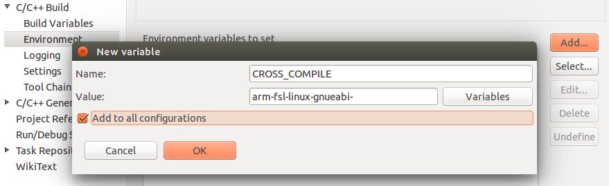

Next we need to pass the environment variables for Cross Compilation.
Highlight C/C++ build > Environment
Click on ADD and create variable to pass cross compiler to build system.
VALUE: arm-fsl-linux-gnueabi-
Tick add to all configurations.

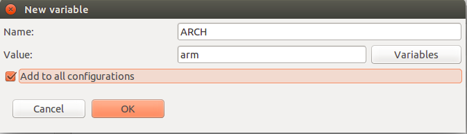

Similarly update the target architecture with ARCH variable.
VALUE: arm

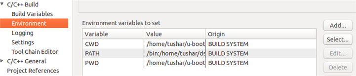

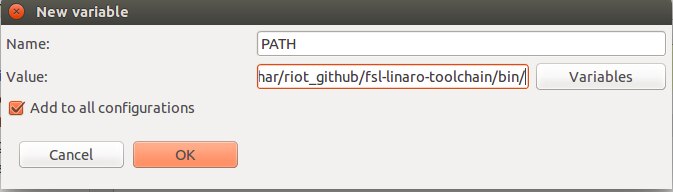

Similarly update path with cross compiler location
VALUE: /home/tushar/riot_github/fsl-linaro-toolchain/bin/

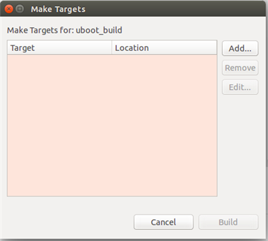

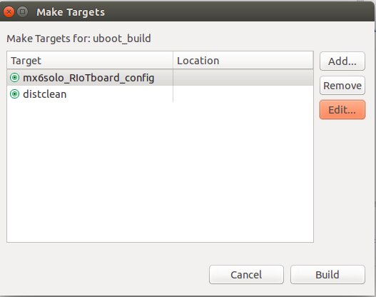

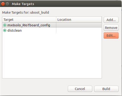

Select Project > Make Target > Build  in menubar or  hit {shift+f9} in keyboard to get make targets menu.

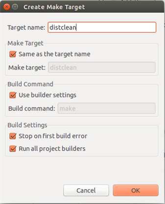

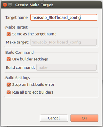

We have two activities (make mx6solo_RioTboard_config & clean) to be performed on project, so we create two targets.
Click Add and create as shown below.
Once configured we have two build targets.
with all setting completed we will proceed to build our bootloader.
Hit {shift+f9} to pop up the build target window.
Select distclean & click build
a “make distclean” command will run removing all the object and temporary files.

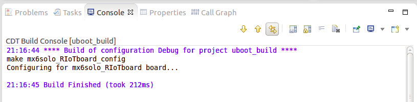

Again Hit {shift+f9} to pop up the build target window.
Select mx6solo_RIoTboard_config & click build.
a “make mx6solo_RIoTboard_config” command will run and configure the uboot to be build for Riotboard.
On config complete we will get below in console window.
With the above build we have a uboot source ready for Riotboard.

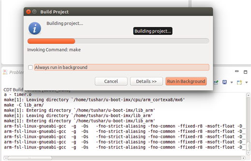

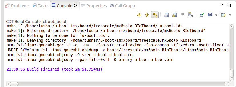

In menubar Select Project > Build Project to fire the make command and build the bootloader.
On build complete we will get in console ...
Our shiny new bootloader is available at “~/u-boot-imx/u-boot.bin” and ready to be booted.
