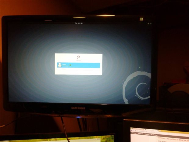

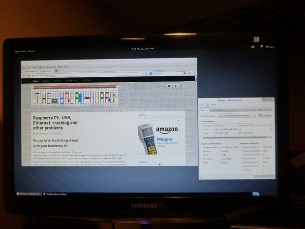

I have been following the previous posts from agrahambell   and a lot of google searching and reading (PI and BBB stuff is really helpful) I now have a fully working GNOME desktop including browsers, editors, music players etc. Basically the GNOME install is everything including the kitchen sink.. hence the filling of the card.
This is based on agrahambell image linked at the bottom of his 5 post regarding building the base image for the board, you can find that here:The specified item was not found. it is at the bottom of the post. The patch required to expand the file system is attached to this post. This was kindly provided to me by agrahambell
So this is not easy for the none native LINUX person, therefor I decided to document everything I did and post it hear for everyone to see and hopefully add to if necessary.
NOTE THIS CAN TAKE MANY HOURS TO COMPLETE, ESP THE GNOME INSTALL... you have been warned

We have now re-sized the SD card, now hopefully we can install a GUI desktop etc
Add a bunch of utilities to help with the install and other stuff
So to add to the base install, the following things where selected (This takes a while)
- other installs use this for pretty selection screens
apt-get install dialog
apt-get install vim        <- VI text editor
apt-get install sudo       <- us none Linux pros seem to like this to run as admin
apt-get install xorg       <- x windows core
apt-get install gnome  <- the desktop environment including the kitchen sink (2GB)
as the gnome install is so slow (Hours), you can fire up another ssh and continue in that for the user creation below

Scan and configure WIFI if needed
iwlist wlan0 scan
if the driver for you wifi is working, you should see a list of wifi access points transmitting in range, including their SIDs, if not then you need to get a driver installed, see agrahambell blogs linked in above
edit and setup etc/wpa_supplicant.conf
network={
             ssid="wifi_name"
             psk="wifi_key"
now bind it all up
wpa_supplicant -B -iwlan0 -c/etc/wpa_supplicant.conf –Dwext
dhclient wlan0 to get IP address
