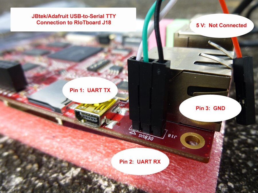

In order to physically connect the JBtek (or Adafruit) serial cable to the RIoTboard J18 interface, use the following connections (with no power applied to the RIoTboard):
JBtek White wire (RXD) to J18 Pin 1 (UART2_TXD) (farthest pin from corner of board)
JBtek Green wire (TXD) to J18 Pin 2 (UART2_RXD) (middle pin)
JBtek Black wire (GND) to J18 Pin 3 (GND) (pin closest to corner of board)
JBtek Red wire (5V) is unconnected
Here is a photo of the J18 interface after the JBtek cable has been connected (references to Pin numbers in the photo correspond to the J18.pin-out, not the JBtek cable):
If you compare the photo above with that provided by Erich Styger for the Embest  UART8000-U cable connection in his post(mentioned and linked above one very important point stands out there is no common color coding scheme for these serial cables In other words if you try to connect the JBtek(or Adafruit cable to the RIoTboard by matching the wire colors in Styger's photo you will mis-connect the cable Guaranteed Also remember this fact if you are trying to connect some other cable not discussed in this post because it may well have a different pin-out/color scheme compared to any discussed here For example some serial cables have CTS/RTS lines as well
Another point that is probably worth mentioning has to do with the unconnected JBtek red wire (+5 Volts). If you look carefully at the photo above, you can see that the internal metal structure of the box-shaped connector on the end of the red wire is not entirely shielded by the insulating plastic (look at the edge of the Pin 3 bubble where it overlaps the connector). For the connectors attached directly to the RIoTboard J18 interface, this is not likely to cause problems, but the exposed metal on the loose JBtek red wire connector might come into contact with the grounded shells on the RIoTboard Ethernet or USB connectors for example. Therefore, it is a good idea to completely cover the connector on the JBtek red wire with some sort of insulation to prevent inadvertent contact with anything on the RIoTboard when the USB end of the cable has been mated to a USB port.
