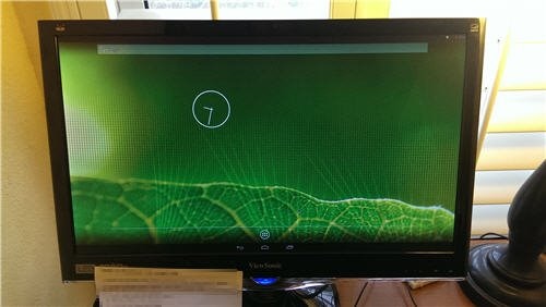

And within about 20 seconds, I was looking at my Android start screen:
To see your home screen, just click and drag the lock symbol in any direction just like you would on an Android phone:

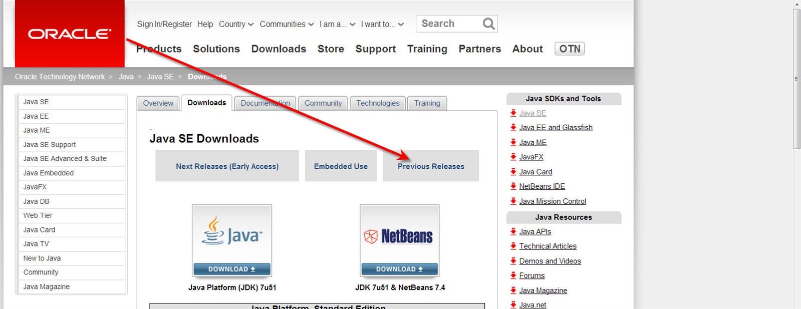

2. Click on "Previous Releases":

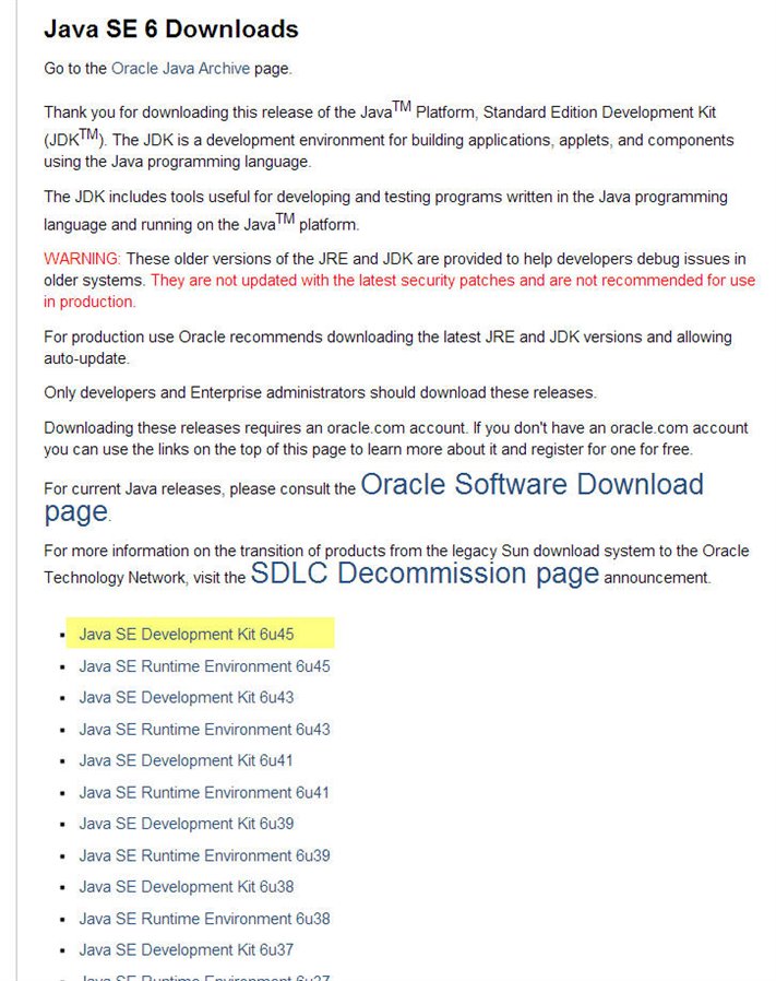

4. On the next page, scroll down and click on the link for "Java SE Development Kit 6u45":

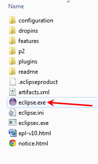

Once ADT has finished unpacking, I recommend creating an alias to the Eclipse application. Browse to the wherever you extracted ADT, go into the Eclipse subdirectory and make a shortcut to the eclipse executable::
