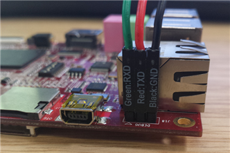

If you have not yet installed the UART-8000-U drivers, visit my previous guide for detailed instructions.
Use the UART8000-U to connect the RIoTboard to your PC as in the image. The debug header you are looking for (J18) is tucked away in a corner between the Ethernet port and the USB OTG we used to flash the board

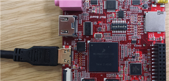

Connect the LCD8000-97C

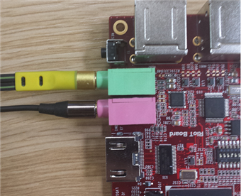

Connect your speakers and microphone into their appropriately colour coded inputs

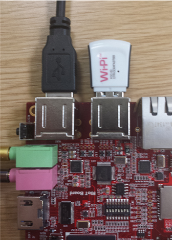

Connect the WiPi and CAM8100-U into two of the empty USB ports

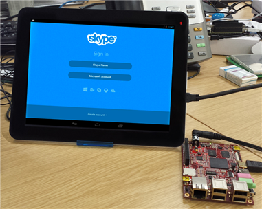

All Doneimage
You'll find the Skype icon in the applications tray, log in and call someone.
You will notice that the CAM8100-U can be used along with the microphone and speakers to enable video chat!
