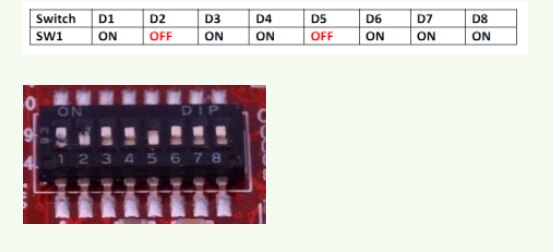

To flash sdcard image :
cd tmp/deploy/images/riotboard
sudo dd if=fsl-image-fb-riotboard.sdcard of=/dev/mmcblk0 bs=1M
make sure the boot switch is set to boot from sdcard
For more instructions on sdcard setup, check here.
