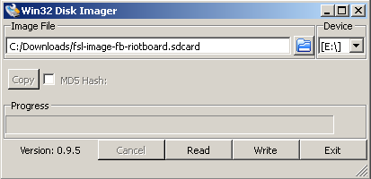

Unzip the bundle and click on Win32DiskImager.
The Win32diskimager is mostly used to flash images to sdcards. It can be used to read back the OS images also.
Once opened it will display a box like this:
Using the Folder Icon on that screen, locate the place to where we have downloaded the OS image .
Make sure you are using a SDCARD with atleast 4GB space. I am using a 8GB sdcard for this demonstration.
It will show a window to select image,
In file types select all images (*.*).
Point to the Image location.
Select image and click open.
Once Image selected it will show like this
Next select the Device (Drive letter we earlier noted E)

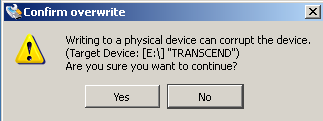

CAUTION: be careful with drives, mistake in DRIVE LETTER can wipe out all your drive data.
Click on Write button to start flashing image to sdcard.
Click Yes when asking for confirmation, ..

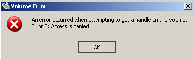

If you get below error you don’t have access/privileges.
You need to have administrative privileges to proceed.

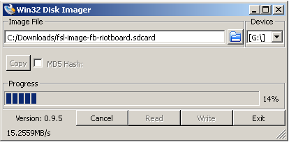

You will get a progress bar while write operating is performed.

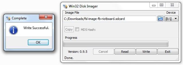

It will take few minutes to complete
Once completed ,  plug in the SDCARD to J6 in Riotboard.
Make sure the boot switch are in SDCARD mode before powering on.
Once Powered on it will boot with Kernel 3.10.17 .
