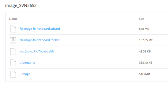

To setup we need to download a SDCARD image with an updated kernel first.
The updated kernel source can be found here.
We will be downloading the fsl-image-fb-riotboard.sdcard image.
https://www.dropbox.com/sh/8ebbtcork0l2cua/AACH4U7ovJYIJvge1VLdWueJa/image.rar
The SVN2652 has
Image NameDescription
SDCARD image for RIoTboard
fsl-image-fb-riotboard.tar.bz2
Root File System bundle.
imx6solo_RIoTboard.dtb
Device Tree Binary
u-boot.imx
Bootloader
uImage3.10.17 kernel

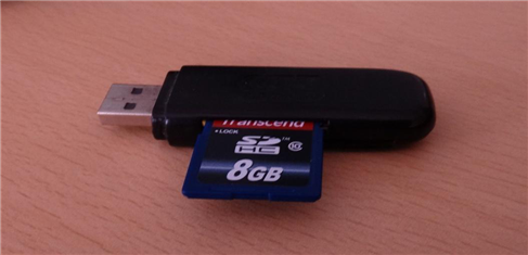

First we need to detect the memory device.
I am using in built-in SDCARD adapter in my laptop and it shows SD card as mmcblk device.
# ll /dev/mmc*
brw-rw---- 1 root disk 179, 0 Jul 29 17:19 /dev/mmcblk0
Using a USB-SD adapter shows a sdb device .
# ll /dev/sd*
brw-rw---- 1 root disk 8, 0 Jul 29 11:26 /dev/sda
brw-rw---- 1 root disk 8, 3 Jul 29 11:26 /dev/sda3
brw-rw---- 1 root disk 8, 5 Jul 29 11:26 /dev/sda5
brw-rw---- 1 root disk 8, 6 Jul 29 11:26 /dev/sda6
brw-rw---- 1 root disk 8, 7 Jul 29 11:26 /dev/sda7
brw-rw---- 1 root disk 8, 8 Jul 29 11:26 /dev/sda8
brw-rw---- 1 root disk 8, 16 Jul 29 16:45 /dev/sdb
CAUTION: Most Linux machines shows harddisk as sda. Our device will be mostly something like sdb,sdc ....
                       We will be carefully selecting our device so that we don't wipe out our SDA harddisk partition
to confirm our device name, plug in and plug out the card reader and execute the command ( ll /dev/sd* )  to determine the device number.
If the device is mounted by default , manually unmount the device  before proceeding.
# umount /dev/sdb
Once we have completed the device detection , we will use below command to setup a kernel 3.10.17 based bootable sdcard.
# sudo dd if=fsl-image-fb-riotboard.sdcard of=/dev/sdX bs=1M
      (where sdX is the detected sdcard device)
Once the command completes, power down the card, remove it, plug it into J6 of RIoTboard and power on the board.
Make sure the boot switch are in SDCARD mode before powering on.
Once Powered on it will boot with Kernel 3.10.17.
