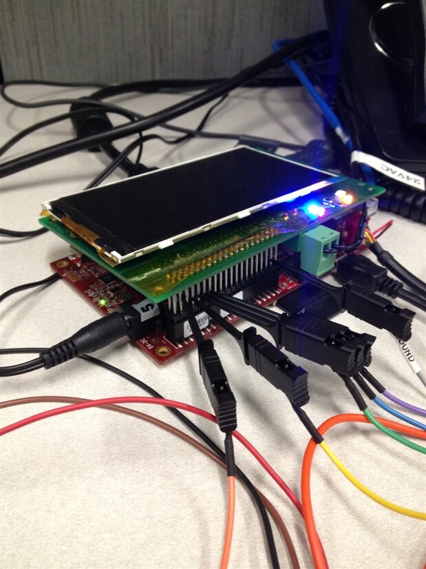

Recompiling Android for use with Parallel RGB TFT LCD and Capacitive Touch Panel
e14 Contributor
Hi everyone. I am attempting to use the RIoT Board as the basis for a HMI design. I hope to document my progress in this forum. My only other experience configuring and building an embedded Linux/Android device is with the Beaglebone Black so I will be learning about the I.MX 6 and RIoT Board along the way.
My plan is to make a "shield" or "cape" style adapter board which breaks out all of my required I/Os and allows me to connect a parallel RGB LCD and capacitive touch panel.
I plan on configuring the RIoT board with the following I/Os:

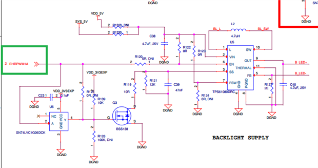

    Looks like I need another PWM for brightness control of the LCD backlight. PWMS are in short supply!
    I plan on closely following the schematic of the BeagleBone LCD4 Cape for the LCD.
    https://github.com/CircuitCo/BeagleBone-LCD4-RevA1/blob/master/BeagleBone-LCD4-RevA1-schematic.pdf

    Well I've had some problems.  I got a USB TTL serial cable so I could see what was going on during boot and I managed to blow up my board. My best guess is that I connected a 5 volt VCC line to one of the pins by mistake. I'm not sure. I was getting nonsense in my terminal window, then nothing, then the chip got really hot. : (
    So I ordered a new one and am carrying on. This time I was very careful to scope all the pins before connecting anything and I cut the 5V line so I can't touch anything by accident.
    Presently I am having trouble getting either the supplied Android image or one I've generated to boot from the eMMC. There are no problems during the MFGtool flashing process. The boot process begins but hangs on the line:

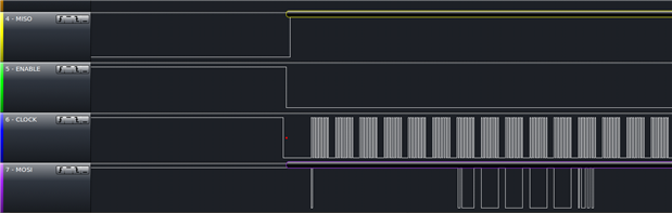

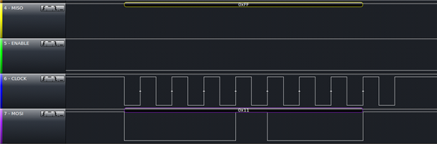

    SPI Port Problems
    Hey guys,
    I've got a cape/shield now but I'm having trouble with the SPI port.
    Getting access to the SPI port
    Just as a reminder, I'm using the Android distribution provided for the Riotboard which has the older kernel and uses board.c files instead of device trees. I'm trying to use ECSPI1 to send the initialization commands to the LCD. I realize I should be using some sort of kernel module to do this but I've had a little experience using spidev in userspace so I thought I'd try sending the commands that way first. Althoug I did find a good tutorial on writing SPI kernel modules. (Writing a Linux SPI driver - Part 1)
    I found this thread on the Freescale message board which discusses how to get spidev working.
    https://community.freescale.com/thread/302612
    The pin multiplexing is set in board-mx6dl_RIoTboard.h
    /* CSPI */
      MX6DL_PAD_KEY_COL0__ECSPI1_SCLK,
      MX6DL_PAD_KEY_ROW0__ECSPI1_MOSI,
      MX6DL_PAD_KEY_COL1__ECSPI1_MISO,
      MX6DL_PAD_KEY_ROW1__GPIO_4_9,
    Then the port is initialized in board-mx6dl_RIoTboard.c, where it is set up to use the ads7846 touch panel driver. I changed the init structure to match my needs.
    static struct spi_board_info imx6_RIoTboard_spi_devices[] __initdata = {
                    /*.modalias = "ads7846",*/
                     .modalias = "spidev",
                    .bus_num = 0,
                    .chip_select = 0,
                    .max_speed_hz = 1500000,
                    /*.irq = gpio_to_irq(RIoTboard_RES_TCH_INT),
                    .platform_data = &ads7846_config,*/
                    .mode= SPI_MODE_3
    Then in the board initialization function I made sure that the correct SPI bus was being initialized.
    * Board specific initialization.
    static void __init mx6_RIoTboard_board_init(void)
    /* SPI */
      imx6q_add_ecspi(0, &mx6solo_RIoTboard_spi_data);
      spi_device_init();
    I had to make sure that the spidev module added was into the kernel. In the file /kernel_imx/arch/arm/configs/imx6_android_defconfig I changed the line:
    # CONFIG_SPI_SPIDEV is not set
    to:
    CONFIG_SPI_SPIDEV=y
    Once I had all that done I recompiled the Android image and put it on an SD card. When I looked in /dev I was rewarded with a file called spidev0.0.
    Compiling a binary to run on the Android shell
    To test the SPI port I decided to use the spidev_test.c from:
    https://git.kernel.org/cgit/linux/kernel/git/torvalds/linux.git/plain/Documentation/spi/spidev_test.c?id=95b1ed2ac7ffe32…
    First I changed the spidev.h location to be:
    #include </home/riot/android-imx6-jb4.3-1.0.0/kernel_imx/include/linux/spi/spidev.h>
    and the device to be:
    static const char *device = "/dev/spidev0.0";

    Everything nearly worked correct. I was scoping the output on my logic analyser and noticed that my Clock isn't operating at the correct polarity.
    The clock polarity appears to be mode 0 no matter what mode I set the spidev to be. Changing the frequency affects the output correctly. It's just the mode that won't change.
    Does anyone know what I may be doing wrong?
    e14 Contributor over 12 years ago in reply to e14 Contributor
    The problem was that SPI modes with CPOL high aren't implemented in the spi_imx.c driver.

    I made the changes he suggested, however I still can't get my LCD to initialize correctly. The clock is at the right polarity now however there seems to be an extra pulse at the end of every message.
    In the following instance I sent 0x11. That clocks out correctly, then there's one extra pulse of nothing at the end.
    I'm in touch with my LCD manufacturer. Hopefully they can help.
