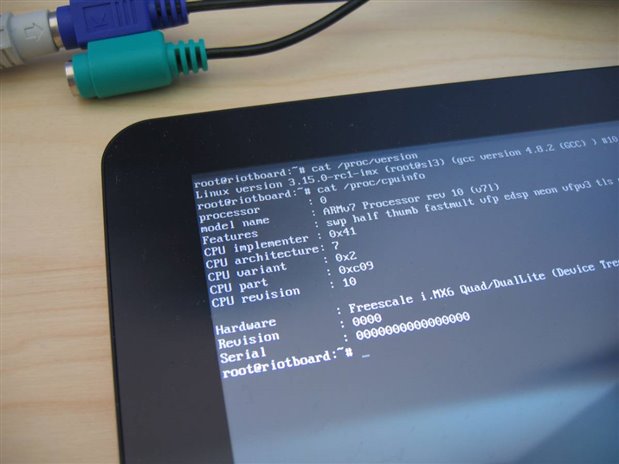

Yep folks, it's possible to have a current linux kernel on the RIoTboard

Oh, and I really, really hate shiny screens image

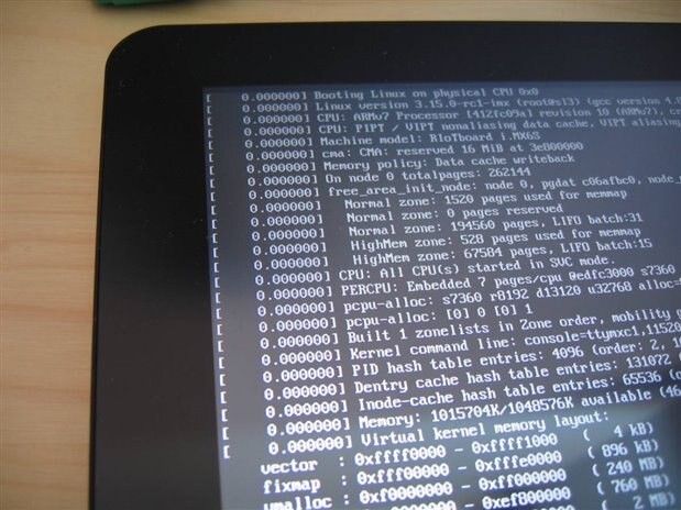

    I was surprised that I could manage to use selsinork processes to get Debian running.  All is well except that I do get the demx image of u-boot on the LCD8000-97C screen but not the Debian console. I could however access the RIot via the TTL console and SSH.

    If you're using a 3.15+ kernel with my devicetree then you can't (easily) use any LVDS connected display. There are a couple of reasons for this.
    1. there's an issue with the imx-drm display driver (or more correctly with the selection of which clock to use for the IPU) that prevents the ability to have both HDMI & LVDS enabled at the same time. You have to chose either HDMI or LVDS and build a separate, different, devicetree for each configuration.
    2. There's a problem related to ethernet interrupts in low power modes that's best resolved by using GPIO6 to to mirror interrupts in that mode. However GPIO6 is used by the touchscreen I2C interface connected to the LVDS interface.
    As there's no driver for the particular touchscreen controller used on LCD8000-97C in the upstream kernels, and due to the relative cost of the display, I deemed it to be an acceptable compromise to use GPIO6 in order to provide reliable ethernet.
    On the side of not being able to have both LVDS & HDMI in the devicetree at the same time, it's mostly a case of waiting until the driver issue is resolved before we can enable it.
    Also, somewhat unfortunately, saving the environment is probably not the best of ideas. There's arguably a flaw in the way u-boot handles the environment - it saves it to eMMC. This means that even if you use a different SD card with a different OS you'll get the bootargs that were previously saved to eMMC. This can be problematic for many reasons, but take the example where you want one SD card that uses HDMI and a different one that uses LVDS it becomes difficult to do without manually changing the environment saved into eMMC every time you switch.
    Let me know if you do want a LVDS only setup and I'll build a devicetree for you with that functionality as well as some instruction on how to clear the saved environment and the changes you'll need for /bootscript to accomplish it.

    Go here https://drive.google.com/folderview?id=0B-WIc2IIJv2FQURpR2V0MkhhUjg#list and download the lvds version of the kernel.
    Copy it onto the RIoTboard and then extract it with
    tar xf linux-kernel-imx-lvds-3.15.0-armv7l-101.txz -C /
    then reboot.
    When u-boot prompts, press a key to break into the u-boot shell and type the following.
    mmc dev 2
    mmc erase 300 1
    now type 'reset' or push the reset button.
    You should see something like the following
    U-Boot 2014.07-rc3-00065-ge606136-dirty (Jun 14 2014 - 13:33:50)
    CPU:   Freescale i.MX6SOLO rev1.1 at 792 MHz
    Reset cause: WDOG
    Board: RIoTboard
    I2C:   ready
    DRAM:  1 GiB
    MMC:   FSL_SDHC: 0, FSL_SDHC: 1, FSL_SDHC: 2
    *** Warning - bad CRC, using default environment
    auto-detected panel LCD8000-97C
    Display: LCD8000-97C (1024x768)
    In:    serial
    Out:   serial
    Err:   serial
    Net:   FEC [PRIME]
    what we're looking for is the highlighted line that tells us that we're using the compiled in environment rather than one saved to eMMC.
    When the board has booted, edit /bootscript and find this line
    bargs=setenv bootargs console=${console},115200n8 rootwait root=PARTUUID=${btpart}
    change it to look like this
    bargs=setenv bootargs console=${console},115200n8 rootwait root=PARTUUID=${btpart} enable_wait_mode=off
    disabling wait mode solves the ethernel interrupt problem at the expense of some extra power consumption.
    The general idea here is not to edit any environment settings within u-boot, and never to use saveenv. Instead change the settings in /bootscript which means they only affect the device you're currently booted from, instead of every possible place you could boot from.
    For anyone who may be interested, the change to the devicetree that allows the LCD8000-97C to work is here https://github.com/selsinork/linux/commit/e9bce885d404ce86525dbab36faf84015bc53aac
    The change also re-enables the I2C controller connected to the LVDS connector. However this won't get the touch-screen working as there's no driver for tha chip in the upstream kernel at this point in time. The intent is only to give the option of a userspace driver or to allow for someone to forward port the 3.0.35 driver as I don't have time to even attempt it right now.
    Good luck, and do let us know how you get on with it!

    Yip, it works.. I now try to port the touch screen driver.image
