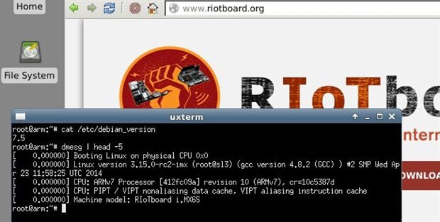

I'm not quite ready to post the next pieces, but thought you might like to see where I've got to:
running XFCE 4.8 here.
    howto?
    e14 Contributor over 12 years ago in reply to e14 Contributor
    Not yet image
    I'm still working through it myself, trying to document things as I go.  Watch out for my blog posts in the RIoTboard area as I walk through the various different steps.
    e14 Contributor over 12 years ago in reply to radiatortwo
    For that I used one of Robert Nelsons minimal filesystem builds from his wandboard page, then did the update from 7.4 to 7.5 and installed xfce, mostly as a proof of concept and to show that there is light at the end of the tunnel image

    Next steps on kernel build are here http://www.element14.com/community/community/knode/single-board_computers/riotboard/blog/2014/05/04/part-3-building-mainline-linux-kernel-for-riotboard
    If you're using my u-boot version, then it simply looks for a file called /bootscript in the root of the first partition on each of J6, J7 & eMMC, loads the content into the environment and runs the environment variable called 'doboot'.  The idea is to punt as much of the decisions as possible to the script instead of the hard-coded part inside u-boot.
    I'll attached the current /bootscript I'm using here in a minute - I don't seem to have the option in this editor.  It loads a zImage not a uImage at 0x12000000 from the same mmc device that /bootscript was loaded from.
    It has some issues in that you might have an SD card installed that doesn't have /bootscript, so end up loading the kernel from eMMC, but then by having /dev/mmcblk0p1 hard-coded you'll get your root partition from the SD card.  I'll sort that out later - it's why I modified my u-boot build to include the part command.
