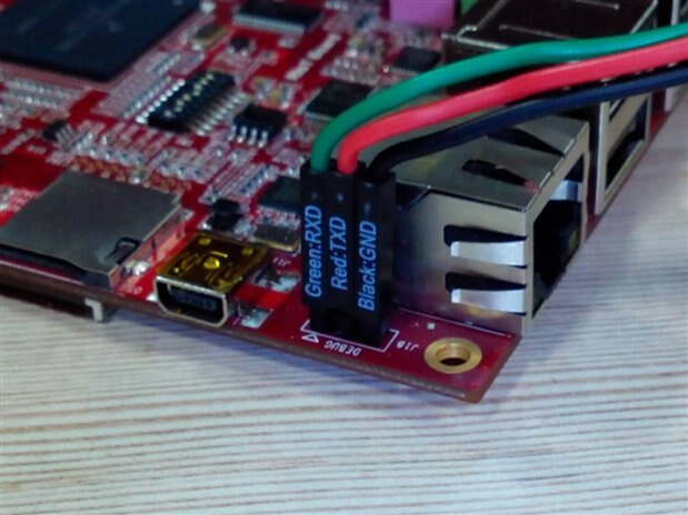

    The terminal for the RIoTboard, in its natural state (Android).  How do I get to it?  And please be gentle on the jargon, as I am a beginner...  Probably gonna write a program for the Smartwatch...

    tusharp over 12 years ago in reply to e14 Contributor
    You can use the same procedure I mentioned above for Android also.
    While connecting a UART cable make sure its connected properly in the J18 connector.
    Below is a snapshot from my setup.
    If you don't have a UART cable you can get a UART8000-UUART8000-U  from e14 website.
    More information about UART and UART8000-U here and here.
