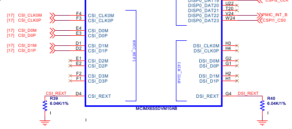

I'm trying to use MIPI DSI interface turn on my LCD,but it no signal on riotboard.
How can I configure the Android kernel to power on the MIPI DSI (J8).
Thanks.

    e14 Contributor over 12 years ago in reply to tusharp
    I can not measure any signal on  MIPI Interface(J8).
    LCD driver ic is ILI9806E.
    Thanks for your help.
  • tusharp
    tusharp over 12 years ago in reply to e14 Contributor
    Just checked  we have support for Himax HX8369 WVGA (800 X 480) mipi dsi  in BSP.
    plz share the official product website of  ILI9806E.
    can you share the product datasheet so that we can plan support for that.
    I used to use Himax HX8369 on pandaboard,It can turn on the LCD.
    But on the RiotBoard, I can not measure any signal on  MIPI Interface(J8).
    Can you help me how to debug it. Always no signal on J8 pin 16, 17, 19, 20.
    tushar panda wrote:
    the MIPI DSI support is available in the kernel.
    according to the schematics, J8 is connected to CSI, not DSI, so will this work at all?
    e14 Contributor over 12 years ago in reply to e14 Contributor
    So, RiotBoard have no DSI interface?
    The SoC has both CSI & DSI, however on page 7 of the riotboard schematics you'll see this:
    What's connected to J8 is the CSI signals at the left, the DSI ones at the right are not connected to anything.
    It's might be possible to use the CSI connections for DSI with some internal re-routing or by specific configuration of the IPU, but that may take a hunt through the 6000 page reference manual for the SoC to find out. tusharp may know how to do this, I haven't investigated it myself.
  • tusharp
    may be a converter needed as CSI pins hardwired.
    I was checking kernel,  firmware support is there but DSI needs to be connected to work.
