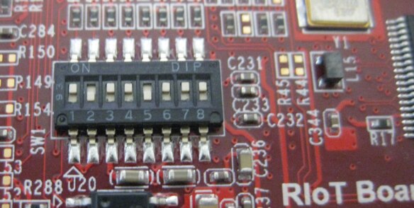

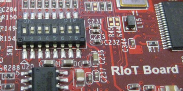

    5. Power off the board and set the switches from the original settings to this Serial Download Settings (1-off, 2-on, 3-on, 4-on, 5-off, 6-on, 7-on, 8-on)
    6. Plug-in the USB cable to J11 (Mini-USB port near Ethernet plug on the board).
    7. Power the board with the 5V power supply. (The board should now be recognized as and drivers getting installed). Once the board is recongnized as usb hid, you can continue.
    8. Now start the MFG tool (tools\Mfgtools-Rel-4.1.0_130816_MX6DL_UPDATER\MfgTool2.exe) as an administrator. (If you get error 21 you need to make sure Mfgtools-Rel-4.1.0_130816_MX6DL_UPDATER\Profiles\MX6DL Linux Update\OS Firmware\ucl2.txt is renamed into ucl2.xml)
    9. Press the “Start” to begin downloading the new image. Don't do anything until the mfgtool says done. (If Windows ask you to format the new drive in a dialog, DON’T DO THIS!)
    10. Press ‘Stop’ and then ‘Exit’ to finish and close the dialog.
    11. Unpower the board.
    12. Restore the previous jumper settings again: (1-on, 2-off, 3-on, 4-on, 5-off, 6-on, 7-on, 8-on)

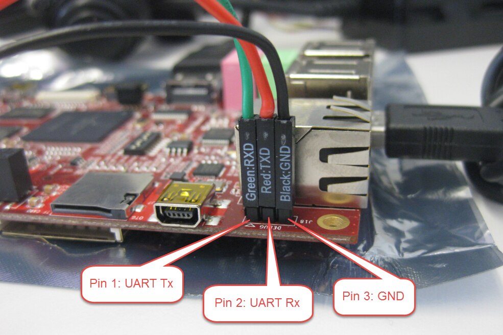

    5. Connect your TTL device to the riotboard, the pin with the arrow is RX, the middle pin is TX and the last pin is ground
    6. Power up your board and press enter when the message to hit any key to stop autoboot pops up

    No sorry, that's a misunderstanding I don't even get to the "press enter" part. When I connect putty with the board and power the board on putty stays blank. This is what I get: Pasteboard — Uploaded Image
    About the ttl, I'm not sure how to find that out. It has a fourth connector that has 5V. Unfortunately there's no real datasheet enclosed in the shop: USB RB-TTL cable for Raspberry Pi from Conrad.com
    Your instructions regarding the putty connection are actually same as I did before. The only thing different now is the image on the riotboard flash memory. Could it be that the mfg tool is at fault?
    EDIT:
    Well I'll be damned, just for fun I tried to exchange the TX and RX connectors and it did boot right away...I'll see if it works now.
  • clem57
    clem57 over 11 years ago in reply to e14 Contributor
    Oh no you have to send TX to RX in both cases . Think TX talks and RX listens and you get the correct picture.
