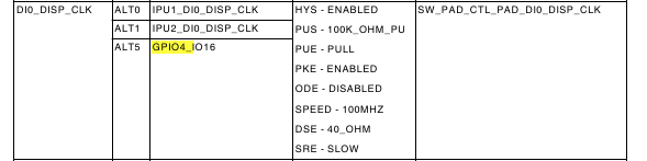

    Anyway, as a simplistic example, if you look at the table on p31 of the user manual, J13 pin 5 maps to a signal called GPIO4_16. You can see the same on p19 of the schematics. Follow the schematics back to page 7 and you'll see the signal labeled GPIO4_16 goes to DIO_DISP_CLK on ball N19.
    Look in the IMX6DQRM.pdf (find it here http://www.freescale.com/webapp/sps/site/prod_summary.jsp?code=i.MX6Q&fpsp=1&tab=Documentation_Tab ) on page 233 you'll find this:
    ALT0, ALT1, ALT5 are the 'pinmux' settings. In other words, that physical pin can be configured for three totally different functions. Meaning that if the physical pin is configured as IPU1_DIO_PIN03 then it won't matter what you do in /sys/class/gpio - you won't see it reflected in the state of the physical pin.
    Dig a bit deeper in the datasheet and you'll see there are 'logical blocks' of gpios - starting at the bottom half of the table on p316 and that they're described as GPIO1 to GPIO7, all apart from 7 having _IO00 to _IO31.
    So looking at the contents of /sys/class/gpio, the logical assumption is that gpiochip0 maps to GPIO1, gpiochip32 to GPIO2, etc. Take careful note that the datasheet starts at 1 with GPIO1_ but the kernel numbering starts at zero with gpiochip0. This off-by-one thing is apt to cause confusion, some boards like the BeagleBone black have used one convention for a certain kernel release then changed to the opposite for a later kernel - meaning that when you export gpio 23 on the later kernel you get a totally different pin.
    So, the example of gpio4_16 means we look at the 17th pin in gpiochip96 (why 17? numbering starts at zero remember), i.e. gpio4_0 is 96, gpio4_1 is 97 and gpio4_16 is 112 so you'd need to write 112 to /sys/class/gpio/export.

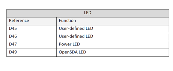

    @david
    there are two user defined leds in riotboard (D45 and D46) as mentioned in pg39 of rioboard manual.
    the gpio leds are exported to /sys/class/leds
    to control leds use below:
    ON/OFF D45:
      echo 1 > /sys/class/leds/user_led/brightness
      echo 0 > /sys/class/leds/user_led/brightness
    ON/OFF D46:
      echo 1 > /sys/class/leds/sys_led/brightness
      echo 0 > /sys/class/leds/sys_led/brightness

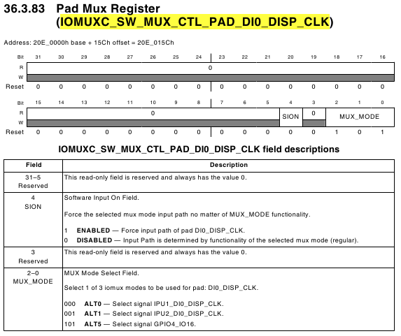

    Some ideas on how to dig deeper.  Lets continue using GPIO4_16 as the example.
    If you don't already have it, download devmem2 from here http://www.lartmaker.nl/lartware/port/devmem2.c
    build it:
    gcc -o devmem2 devmem2.c
    From the ref manual p233

    the last column of the above two tables gives us the registers that control that physical pin.
    Following through the docs, we get the base address and reset value:
    make sure you are logged in as root, or use su or sudo. and do the following
    root@sl3:~# ./devmem2 0x20e0470 w
    /dev/mem opened.
    Memory mapped at address 0xb6f40000.
    Value at address 0x20E0470 (0xb6f40470): 0x10
    root@sl3:~# ./devmem2 0x20e015c w
    /dev/mem opened.
    Memory mapped at address 0xb6f22000.
    Value at address 0x20E015C (0xb6f2215c): 0x0
    My results on a Sabre-Lite show the pin isn't at defaults, it's configured as ALT0 instead of the reset default of ALT5

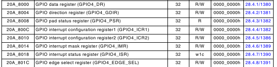

    we can then look at the gpio registers themselves: (section 28.4 p1378)
    root@sl3:~# ./devmem2 0x20a8004 w
    /dev/mem opened.
    Memory mapped at address 0xb6fd6000.
    Value at address 0x20A8004 (0xb6fd6004): 0x0
    or all inputs for me:
    finally read any data:
    root@sl3:~# ./devmem2 0x20a8008 w
    /dev/mem opened.
    Memory mapped at address 0xb6f8b000.
    Value at address 0x20A8008 (0xb6f8b008): 0x107FE0

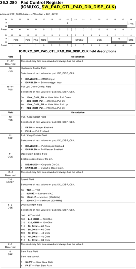

    0 e14 Contributor over 12 years ago in reply to e14 Contributor
    Hi,
    I get the same values here. I would read them as:
    0x20e0470 =  0x8028:
    Drive Strength is 48 Ohm  (Bit 5:3 = 101)
    100 K Pullup is enabled (Bit 15:14  = 10)
    0x20E015C = 0x5
    GPIO4_16 the MUX-MODE is correct (ALT5) (Bit 2:0 = 101)
    So everything seems correct until here.

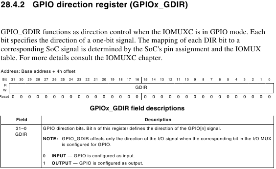

    0x20a8004= 0x200
    GPIO4_16 is configured as an input (Bit 15 = 0)
