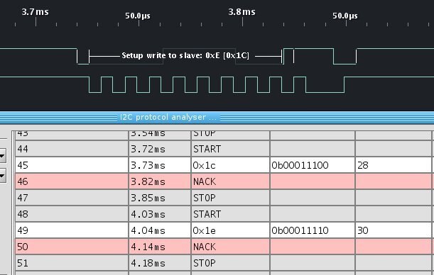

Hi !, i need to test the i2c port on the expansion port, i take a look to /dev and i found i2c-0 ,i2c-1, .... I´m new on this i just wondering if someone could poing me on the right direction, i want to send data on a loop through i2c port and check it on the oscilloscope, that´s it. I´m just not sure where to start.

    Ah ok ok, What i want to do is to test the i2c interface but right now i don´t have any i2c device to interface with so i´m thinking just sending data over the i2c3 interface and check the signals with a logic analyzer.
    I will do it on linux and yes, as you said is the J13 , i2c3 (pin 31 and 33) which is on /dev/i2c-2.
    I already read something about i2c-tools but the thing is that i´m not connecting any device on the port therefore using i2c-detect doesn´t get me any address and i can´t use i2cdump because i don´t know in what address to write data.
    For example when i tested the uart i send the data without the need of connecting anything and i just check the signals with the logic analyzer, i´m new at this and i don´t know how to do that with the i2c interface.

    You may not be able to use the physical i2c3. The reason is that i2c3_sda is likely to be used for the ethernet interrupt workaround.  i2c4 might be a better choice, depending on which kernel you're using.
    i2cdetect probes a range of addresses, so if you connect the scope, you'll see it trying every address with no response.
    Similarly, with i2cdump you can ask it to dump a range of data from a particular address. If you don't have anything connected, it won't matter which address you pick, you won't get any data returned, but you will be able to see the attempts to read the data on the scope, something like this:
    closer in it looks like this
    As you can see the address is clocked out, but no ack from the non-existent device, so we just loop sending addresses.
    The above was done with i2cdetect with nothing on the bus, the output from i2cdetect looks like this:

    With my kernel, /dev/i2c-2 is i2c4 on pins 35 & 37 on J13

    Thanks !!, it works and also you´re explanation was really helpful, .
