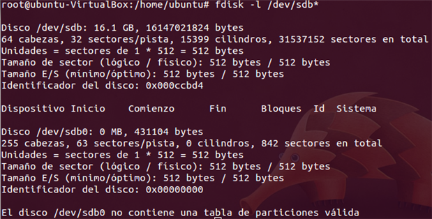

Hello everyone,
Currently I'm trying to install Ubuntu in a SDcard I followed this tutorial: RIoTboard: Updating OS images in Linux Environment but when I want to boot from the SDcard nothing happens, I can't get the outputs showed in page 12 of that tutorial.
I tryed with Linux 3.10.17 SDcard Image but I don't know how it really works ? Do I need just flash with that image ? What happens with the rootfs, I was wondering if it comes inside the SDcard image.
Here is a screenshot when I flash my SDcard with the SDcard image.
Where is apt-get ?
I wish something could help me. I want to run Ubuntu.
I got a 16GB microSDCard.
Thanks in advance.
      that belongs to 3.0.35 kernel based BSP .
      you are using 3.10.17 build on yocto, so difference is expected.
  • tusharp
    0 tusharp over 12 years ago
       could you let us know what exactly you are looking for.
       I can see a terminal above, so you have already flashed the image,
  • tusharp
    if you got the image (548MB) from https://www.dropbox.com/sh/nuhzba8uqpijenb/AAAt8l9g6u6T6-DOqJHozyKca/fsl-image-fb-riotboard.sdcard
    then it comes with a rootfs.
    to confirm rootfs  hit "ls /" in the terminal, it should show file system directories like bin,etc,sbin,proc ...

    Where is apt-get ?
    apt-get is missing in that rootfs, the rootfs is not ubuntu.
    need to copy apt-get binary  from other bsp.
    i hv uploaded apt-get binary here, can you give it a try.

    0 e14 Contributor over 12 years ago in reply to tusharp
    The sdcard was mounted in /dev/sdb, I unmounted and I did the next:
    - I written uboot and uImage(with bs=1M seek=1) in /dev/sdb
    - I created the rootfs in a new partition in the same SDcard /dev/sdb1 (with ext4 fs, and  the uuid specified in the document)
    At the moment of boot it didn't work, I've used the BSP you told me.
    I'm using Ubuntu 12.04.
  • tusharp
    0 tusharp over 12 years ago in reply to e14 Contributor
    can you try flashing in windows using this guide.
