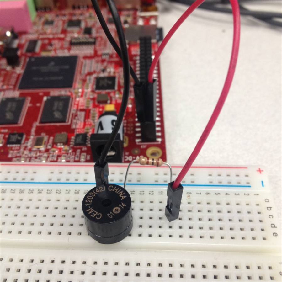

Hey guys,
RIoTboard Piezo Buzzer Test from Luke Marvin on Vimeo.
In this post I was hoping to discuss more about the "division of labour" across the different levels of software. I'm relatively new to kernels and what-not so maybe someone here can lend me a hand.
In my test I have the buzzer connected through a 1k ohm resistor, to PWM 2 and GND.
In my 3.0.35 kernel I have made the following changes as suggested by Eric Nelson (https://community.freescale.com/message/436421):
  1. I updated the leds-pwm.c driver with the changes made in this commit. https://github.com/boundarydevices/linux-imx6/commit/63b106e30a42e5ee89c4c7d0644e853f013276db
  2. I updated my /kernel_imx/arch/arm/configs/imx6_android_defconfig file to include the leds-pwm.c driver. "CONFIG_LEDS_PWM=y"
  3. I added a new platform device to my /arch/arm/mach-mx6/board-mx6solo_RIoTboard.c file using this file as an example. https://github.com/boundarydevices/linux-imx6/blob/boundary-imx_3.0.35_4.1.0/arch/arm/mach-mx6/board-mx6_r.c#L803
  4. I recompiled my kernel and boot image, programmed the board and booted it up.
Now I have a device located at /sys/class/leds/buzzer which I can echo values into, which then plays a sound.

In conclusion, here is my plan. Let me know if it sounds reasonable to you guys.
  1. Modify the pwm-leds.c driver to include a new "attribute" file called wail. When I write a 1 to it, it starts wailing. When I write a 0 to it, it stops.
  2. Set the permissions of the file at boot time.
  3. In my Android app, when there is an alarm I write a 1 to the file. Then write a 0 to cancel it.
    0 e14 Contributor over 12 years ago
    More specifically I was wondering if it is safe to do any sort of loops within the kernel module. I need to alternate between two frequencies for my alarm sound.
    Do I need to make a thread within the module? Or do I just make a user space library that does the looping and call it with the NDK? I really don't know.

    0 tusharp over 12 years ago in reply to e14 Contributor
           userspace libs seems to be good option than modules.
