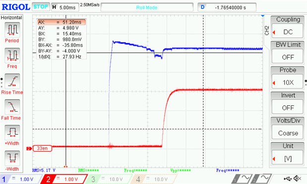

I have found the RiotBoard to randomly hang on startup, showing D45 and D49, and the left ethernet led.  Pressing the reset button allows normal boot.  There is no output on the Debug pins when this happens.  If a usb to ttl serial is connected, it boots correctly, probably because of backfed pull up current from the ftdi converter.
Fix?  As of this writing, it appears that a 1uf cap on D40 (By the audio connector) effectively slows the por_b enough to fix this problem.
    I have one board that didn't respond to this treatment like I would like.  Any ideas what would cause a non start?  When this happens, I am fairly confident there is no activity on the debug port.
    Interestingly, on one board that did it here, whenever the ftdi debug adapter is connected, this won't happen, apparently there is enough current fed from the ftdi pullups that this doesn't occur?

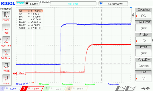

    #1.  Pulled up to what?  I tried grounding this pin without positive results, as pulling this up isn't really applicable, rx and tx are already pulled up to vdd_nvcc per schematic.  Like as mentioned, pulling up externally allows proper boot, but this is more likely due to external current feed rather than uart garbage.
    #2.  I tried this on my bench supply with the same results.  The board boots at 3 volts if you go slow with it.
    See these scope shots with the regular power supply(1.5 amp triad wsu050-1500 Blue is 5v power red is PORB Second image has power not completely drained
    I feel like it is a power sequencing issue.  I also scoped the tx debug pin for action when the problem happens, and there is none.  Out of some 12 boards here, this one is fairly repeatable with the problem.  It only happens when the board has been powered down a few minutes.
    Again, note that with the particular board described here, the 1uf cap on d40 fixes it.

    1. Sorry. My mistake. I forgot the UART pins are already pulled high to VDD_NVCC
    2. Since the issue is the same when using the bench power supply, it seems that indeed there is a POR issue here.
    One solution (that would somehow cope with the effect) would be to increase either the capacitance of the C331 or the resistance of R219. The root cause will still be present.
    a. What about the main oscillator? Can you check if its start-up time between a good and a faulty board is somehow different?
    b. Another thing to check might be the soldering for the decoupling caps.
    If none of these applies, then it might be something faulty with the CPU...
