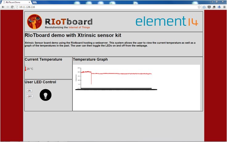

But we want them to look like this
So there are two parts to this. Firstly getting the html page up and running to get the single webpage that does everything, and secondly to get it to run automatically on boot.
The All-in-One HTML page
Being the easiest and most straightforward of the two, we'll start with this. Basically we will have an HTML page with a frame for each php page and a few extra things to make it look good.
The design for the page is a basic 2x4 table with the logos and the description going across both columns and the graph going across across two rows, and a css script to make it more eye catching and exciting. If you don't want to write your own html page I have included my script below, if you do want to write your own script below I strongly recommend using a table for the layout of your page and use iframes to display the php pages, this will allow you to write you page far faster and also make it easier to find the relevant piece of code if something goes wrong.

so that that's pretty much it, I slightly edited the php pages as well.
LED Control
on.php and off.php (which run when you press the on or off button for the LED) now change the led.png image (which is the light bulb) so that the it shows whether the LED is on/off. Also I changed led_blink.php, which displays the buttons and runs the on and off scripts, so that it displays the led.png image next to the buttons.
Current temp
The current_temp.php file I changed so that it showed the °C symbol and the font is the same as the rest of the page by reference css.css

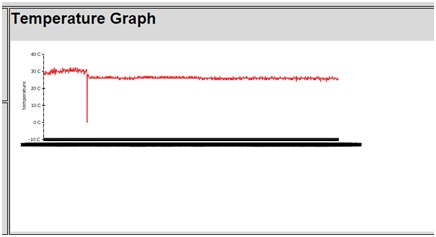

Line Graph
Line_graph.php has been changed a fair bit. I got rid of the title and the box to make it more simple and cleaner. I put a SQL query in that deletes all data that is older than 15 mins, so that the Pchart library doesn't get overwhelmed by data (I left it running when I went to lunch, came back refreshed and the php just didn't load, took me ages to work out that the pchart library has a 30s time-out for drawing the graph), you can change the kill time for data but bear in mind that data is taken every second so 15 mins of data is still 900 points of data being plotted. As you can see I have had a little problem with the X-Axis of the graph, the pchart library prints the label from every data point, and I haven't yet found a way to make it tell that the label is a time and then label the axis neatly without overlaps.

That should be everything. Just reboot the board and load up your internet browser on your PC and load your boards I.P. address. You should now have a fully working single html page. Test out the features by heating the xtrinsic with you hands or clicking the led buttons. The graph will refresh every time you load your page.
