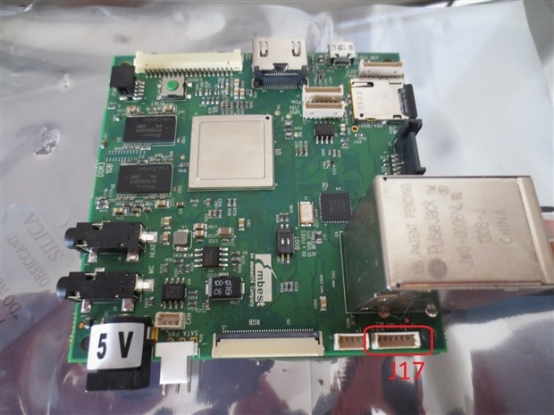

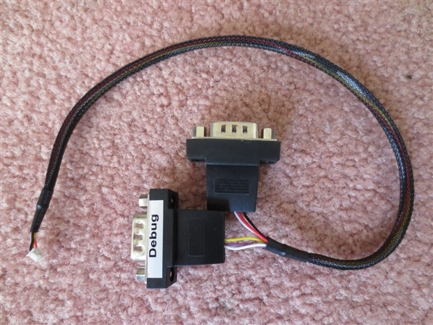

The SABRE Lite development kit comes with a serial connector that can be used to debug any issues that may arise with your board.  Start by connecting the serial connector:
to the J17 connector on the SABRE Lite board:
Then connect the Debug serial connection to your PC.

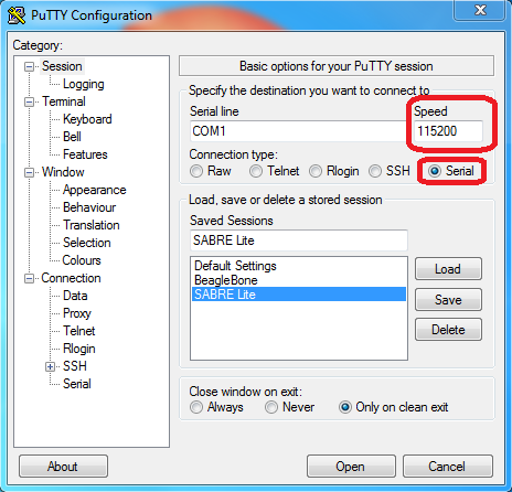

Once the SABRE Lite board is connected to the PC.  Fire up putty on your PC.
Switch the “Connection type” to be “Serial” and input a “Speed” of 115200.

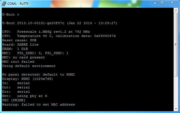

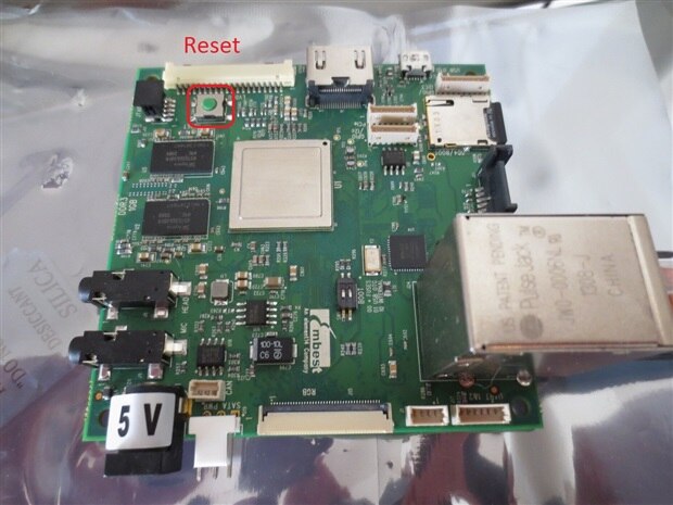

When you click open, chances are that you will see a blank screen.  Hitting enter should bring up a U-Boot command prompt.  The reason that you have to hit enter is that all of the output already went by.  By hitting enter, new output will come over and be displayed.  So, to see the boot sequence, press the reset button on the SABRE Lite:
This will show you the boot information.  Here’s is the first part of the information that you get:
The information that you get can then be used to debug and fix your issue.  Here are some of the ones that I ran into.

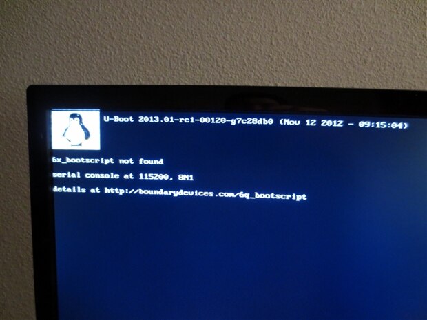

The latest version of Android JellyBean uses the newer 6x_bootscript and my device came with the older 6q_bootscript installed.  This can be discovered by looking at the boot information and seeing a message like unable to read “/6q_bootscript”.  To fix this, you need to update your version of U-Boot.
First, you need to download the upgrade image from:
http://boundarydevices.com/switching-u-boot-versions-on-i-mx6/
You want the 6q_upgrade-20121112.zip file.  This will upgrade you from the 6q_bootscript to the newer 6x_bootscript.  The process is pretty easy.  Extract those files and then write them onto an SD card.  These files can be written by just dragging and dropping them into the SD card.  (No need to use Win32 Disk Imager.)  You can put the files on either a normal SD card or a micro SD card.

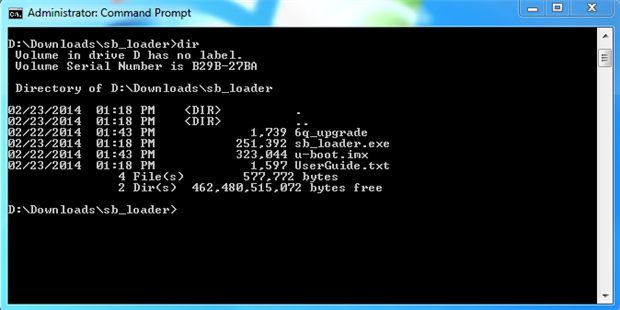

And this time, you want to get the 6x_downgrade-20121109.zip file.  So, put that on an SD card and pop it into the SABRE Lite board.  (I had to change the file name from u-boot.nopadding to u-boot.imx.)
Also, copy over the u-boot.imx file into the same directory that the sb_loader program is in.  (This isn’t strictly necessary, but it makes the command to run the sb_loader program easier.)

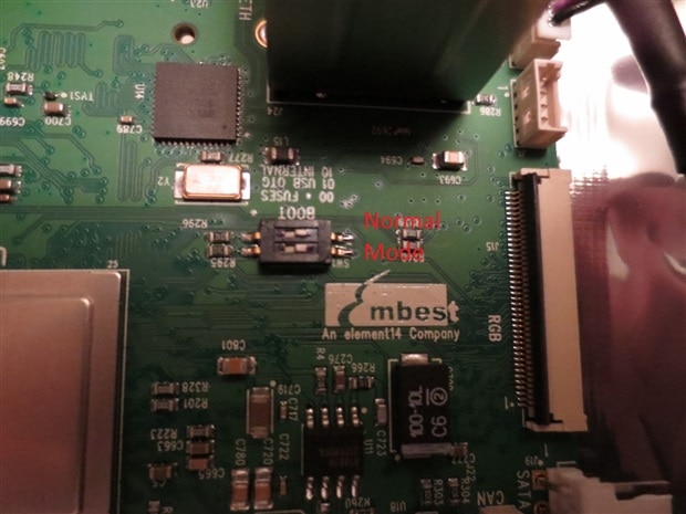

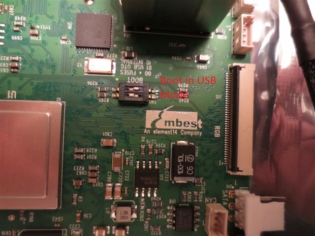

Next you need to set up the SABRE Lite to boot in USB mode.  To do this, flip the switches near the center of the board to look like this:

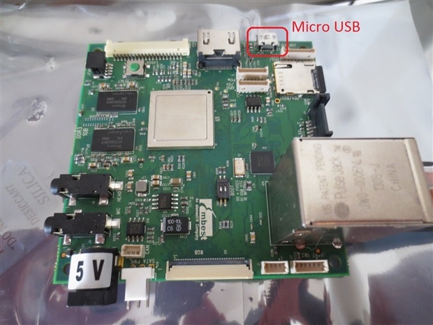

Next, connect a micro USB cable to the SABRE Lite board:
And to your PC.  After the messages about trying to find a driver for your USB device go away, then open up a Windows command prompt and navigate to the directory that contains the sb_loader executable and u-boot.imx.
Excellent, now connect to your SABRE Lite through the serial connection like we did before.  Once everything is set up, run:
sb_loader.exe –f u-boot.imx
And you should see the following output:
Executed plugin successfully.
Succeed to download u-boot.imx to the device.
Run into the image successfully.

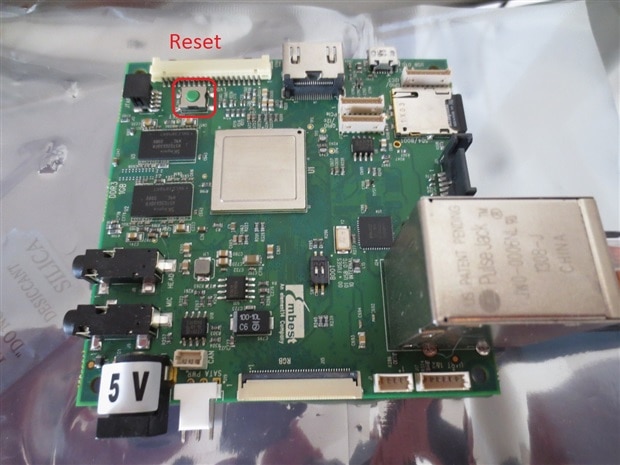

This will flash the old boot loader on your SD card to the SABRE Lite board.  Once this is done, move the switches on the board back into normal mode:
And reset the SABRE Lite. Now it should be back in business using the old boot loader.  To upgrade to the newer boot loader, follow the instructions in the previous section. Note: I tried to go to the new boot loader directly, but it didn’t seem to work.  I had to go back to the old one and then upgrade.
