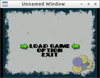

Once this is complete, you can launch GnGeo and see a screen like the following one:
