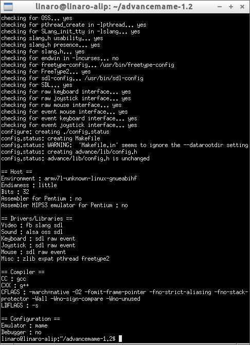

Compiling Advance MAME
The first step is to download the source code, which can be done by:
After the download has completed, then decompress the file with:
This will decompress all of the files in the archive into a new directory called advancemame-1.2.  After this has completed, we need to enter that directory and configure Advance MAME:
This will run through and automatically detect all of the dependencies that we installed earlier. This will also detect things like the type of type of processor and video card.
Now for the big step, compiling Advance MAME:
This step will take a while. About two hours, so this is the kind of thing that you kick off and then go for a jog or call it a night and come back to it in the morning.
When it does complete check to make sure that it was successful.
The last thing to do is to install Advance MAME:

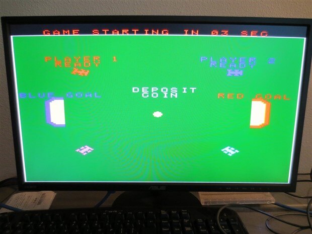

For this example, I’m going to use the Car Polo game.  The first step is to download the ROM:
The file is pretty small, so the download should complete quickly.  When it is done, move the file over into:
~/.advance/rom

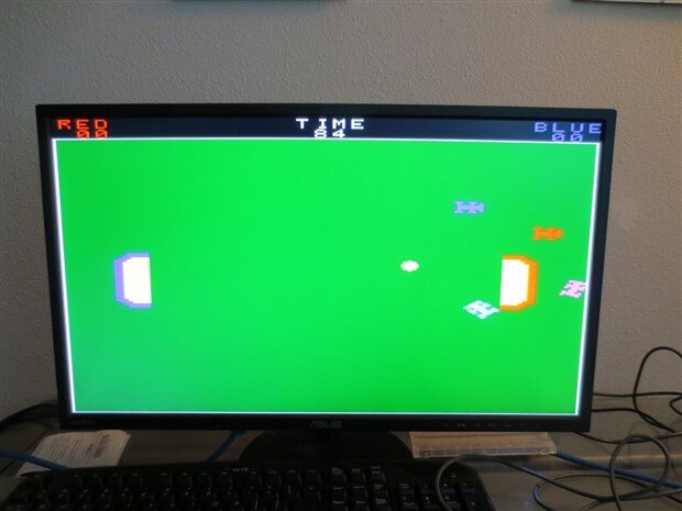

Then you can fire up Advance MAME with:
The goal of the game is to use the car to push around a soccer ball and get it into the other person’s net.  The BBC TV show Top Gear did something similar using compact cars.

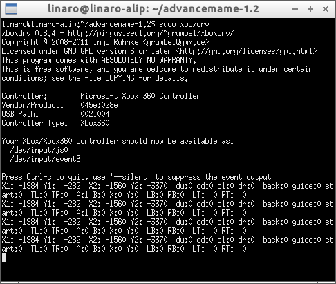

Xbox Controller
Playing an old school game like this is much more fun with a controller than with the keyboard.  I happened to have an xbox 360 controller lying around, so here’s how to set that up.
First we need to install the program that translates the controller movements into keyboard strokes:
Once that is installed, then you can run it with:
If it is working correctly, this should print out some information to the screen every time that you press a button on the controller or move the joystick.  Also, the light on the controller should light up indicating that you are player one.
To change which button on the controller corresponds to which key on the keyboard, use the --ui-bottonmap option.  Here’s some good settings for the car polo game:
This way you can press the red B button to deposit a coin and start playing the game.  The left and right arrows on the D-Pad on the controller rotates which way your car is going.  Finally, the green A button makes your car move.
