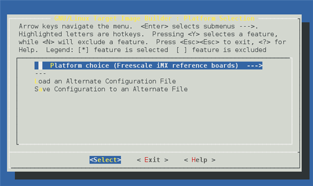

If this completes successfully, then you will be presented with a screen that looks like this:
Using this screen you can set the platform that you would like to compile to.  This setting is already correct by default, so you don’t need to make any changes here.  So, hit the right arrow on your keyboard and select “Exit” and press enter.  It will then prompt you asking whether or not you would like to save.

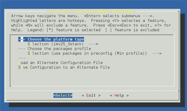

After you save, then you will be prompted with another screen that looks similar to the first one:

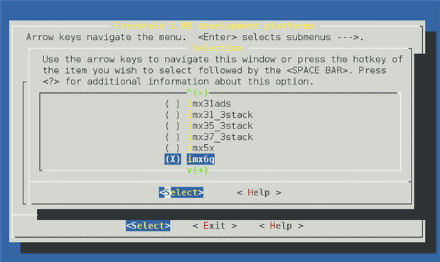

On this screen there are some changes that need to be made.  You need to change the platform type from imx25_3stack to be imx6q.  To do this, highlight the “Selection (imx25_3stack)  --->” line and hit enter.  This will bring up another form that looks like this:
Find the imx6q option and hit enter.  This is the only change that is required for this form, so Exit and save just like we did before.

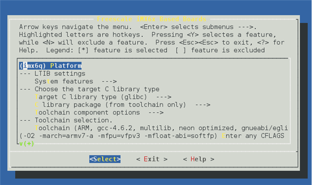

This will bring up one more dialog:
On this dialog, we need to change the board from mx6q_arm2 to mx6q_sabrelite.  The procedure for this is similar to the last change that we made.  After you make this change, exit and save.

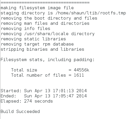

This will kick off a building process.  Unfortunately, this process initially fails for me with an error about a package called busybox.
This is fairly easy to fix. Within your LTIB directory there will be a file called:
dist/lfs-5.1/base_libs/base_libs.spec
Open up this file and make a small modification.  First, find the lines that look like this:
What you want to do is to remove the last two lines:
Once they are deleted, then rerun ./ltib.  When you run it a second time, you will not have to go through the previous screens, it will just start building where it left off.  This time busybox should succeed and you will eventually see a screen that looks like this:
Great success!
