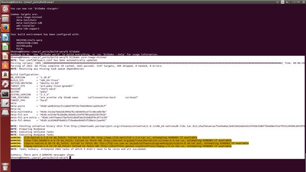

    I tried building the same as shown steps below
    bheema@Bheema:~/warp7_yocto$ MACHINE=imx7s-warp source setup-environment build-warp7
    then by default the kernel will fetch from "include recipes-kernel/linux/linux-fslc.inc" which is located in linux-warp7_4.1.bb
    "/home/bheema/warp7_yocto/sources/meta-fsl-arm-extra/recipes-kernel/linux"
    then
    $ bitbake core-image-minimal
    bheema@Bheema:~/warp7_yocto/build-warp7$ bitbake core-image-minimal
    NOTE: Your conf/bblayers.conf has been automatically updated.
    Parsing recipes: 100% |######################################################################################################################################################################| Time: 00:00:49
    Parsing of 1663 .bb files complete (0 cached, 1663 parsed). 2197 targets, 189 skipped, 0 masked, 0 errors.
    NOTE: Resolving any missing task queue dependencies
    Build Configuration:
    BB_VERSION        = "1.30.0"
    BUILD_SYS         = "x86_64-linux"
    NATIVELSBSTRING   = "Ubuntu-14.04"
    TARGET_SYS        = "arm-poky-linux-gnueabi"
    MACHINE           = "imx7s-warp"
    DISTRO            = "poky"
    DISTRO_VERSION    = "2.1.2"
    TUNE_FEATURES     = "arm armv7ve vfp thumb neon       callconvention-hard       cortexa7"
    TARGET_FPU        = "hard"
    meta
    meta-yocto        = "HEAD:ae9b341ecfcc60e970f29cfe04306411ad26c0cf"
    meta-oe
    meta-multimedia   = "HEAD:55c8a76da5dc099a7bc3838495c672140cedb78e"
    meta-fsl-arm      = "HEAD:e2254e7b2ded0c2b66b1226f879b3a6d52037b2d"
    meta-fsl-arm-extra = "HEAD:e95f4ae61fdaf6452d6dfa9cb59dbdf9cdf73c99"
    meta-fsl-demos    = "HEAD:a165068f8a0d1cf29aabe4b4053f28be1c2aa492"
    NOTE: Fetching uninative binary shim from http://downloads.yoctoproject.org/releases/uninative/1.0.1/x86_64-nativesdk-libc.tar.bz2;sha256sum=acf1e44a0ac2e855e81da6426197d36358bf7b4e88e552ef933128498c8910f8
    NOTE: Preparing RunQueue
    NOTE: Executing SetScene Tasks
    NOTE: Executing RunQueue Tasks
    WARNING: zlib-native-1.2.8-r0 do_fetch: Failed to fetch URL http://www.zlib.net/zlib-1.2.8.tar.xz, attempting MIRRORS if available
    WARNING: linux-libc-headers-4.4-r0 do_fetch: Failed to fetch URL http://kernel.org/pub/linux/kernel/v4.x/linux-4.4.tar.xz, attempting MIRRORS if available
    WARNING: libpcre-native-8.38-r0 do_fetch: Failed to fetch URL ftp://ftp.csx.cam.ac.uk/pub/software/programming/pcre/pcre-8.38.tar.bz2, attempting MIRRORS if available

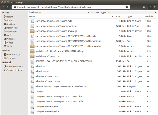

    after this execution i got the images in folder "/home/bheema/warp7_yocto/build-warp7/tmp/deploy/images/imx7s-warp"
    i shall port this sdcard image and let you know the status of working on warp7 board.
