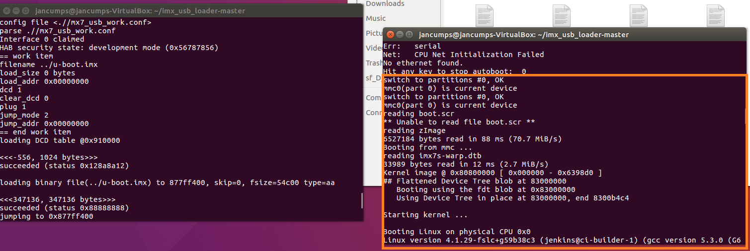

Above compilation process will create imx_uart and imx_usb binaries.
We will use the imx_usb binary, the imx_usb loader detects the Freescale devices and flashes the u-boot to ram.
Make sure the warp7 is plugged in before proceeding.
Open a serial terminal (ex: minicom) and configure the serial device, in my case its ttyUSB0
Step4:
Setup warp7 hardware, Flash uboot and mount the emmc.
1. Remove the CPU board from the base board.
2. Put the dip switch2 in the upper position.
3. Reconnect the CPU board to the base board
4. Connect USB serial cable between the  base board and PC.
5. Connect USB power cable between the cpu board and PC.
Now copy the uboot binary to home directory, so that its easier to locate while flashing.
cd ~
cp ~/warp7_yocto/build/tmp/deploy/images/imx7s-warp/u-boot.imx .
Now run the imx_usb with the u-boot.imx in path as argument.
You will see the below as output in minicom terminal once flashing completes.
The uboot halts the booting process as it finds no partition table to load kernel.
This confirms the uboot is loaded to RAM.

    Jan Cumps over 9 years ago in reply to andreea
    no matching USB device found
    I had the same issue and got it solved.
    I had to check the Freescale and FTDI devices in VirtualBox after plugging them in.
    Then I got /dev/ttyUSB0 and /dev/ttyUSB1
    I configured minicom to /dev/ttyUSB0 , switched off hardware flow control and saved to the default conig..
    sudo minicom
    CTRL-A O
    A change port
    F change hardware control flow
    enter
    Save to dfl
    Then executing the uboot load worked.

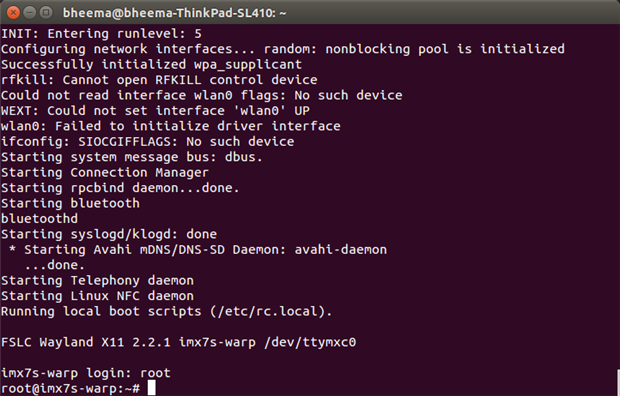

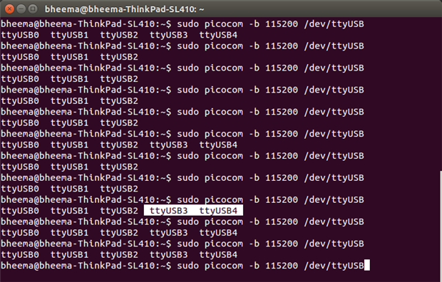

    After loading the u-boot and image(following above steps) to the warp board try the below options, it worked for me:
    first insert the usb cable-1 from your machine to IO board of the warp7 (donot connect the second usb cable of CPU board of warp board now itself )  and open the terminal and check the serial port (here i am using picocom -b 115200 /dev/ttyUSB3) you can see the connected warp7 board port connection as /dev/ttyUSB3 (USB3 in my case)
    now connected the second usb cable to the cpu board of the warp7 board you can find one more usb port getting detected i.e /dev/ttyUSB4 (USB4 here) in picocom serial terminal window.

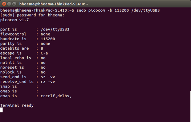

    now you can open the serial port terminal "picocom -b 115200 /dev/ttyUSB3" from an terminal window
    now press the reset button which is present in IO board of the warp7 board: you will get the warp7 login prompt as shown below:
