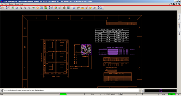

I'm wondering what PCB design software the supplied *.brd files were produced in? Not Eagle by the looks of things...
I need to make a different IO/daughter board and a snug fitting enclosure for a product we are developing and need some critical dimensions.
If possible it would be really helpful to get a .dxf, .dwg or other generic cad output of the component footprints for the community to use.

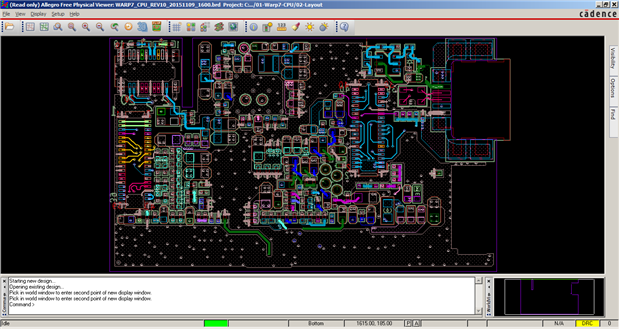

    It is confirmed that warp7 pcb design has been developed using Allegro software and it can be viewed using Allegro Free Physical Viewer 16.6
    below are the snapshots of the same:
    warp7 CPU board:
    Warp7 IO board:
