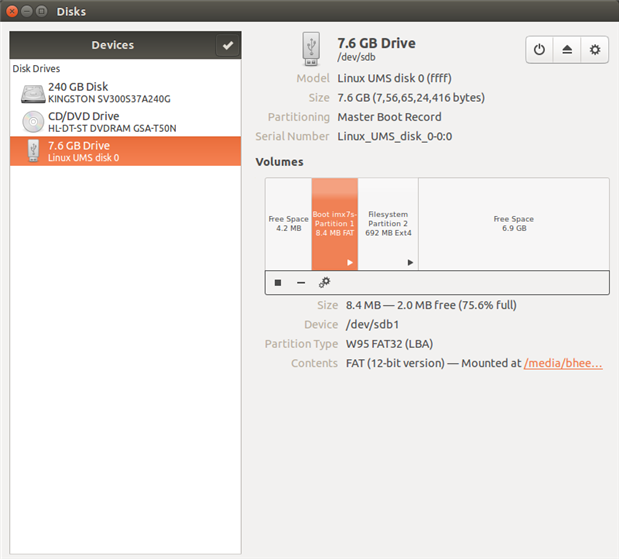

Hi All,
I accidentally deleted all partitions except U-Boot portion of the MMC on Warp 7 board.
I am getting UBoot prompt but not able to find a way to create boot partition and boot up the WaRP7 board.
Can anyone know how can I handle this situation?
Thanks,
Vivek
  • bheemarao
    0 bheemarao over 9 years ago
    Hi Vivek,
    Run the DFU command in u-boot mode
    => dfu 0 mmc 0
    then your warp board emmc will be visible on host system then you can follow the custom partition using any gparted tool
    below is the snapshot of the emmc memory partition details for warp7 board:
    Regards
    Bheema Rao

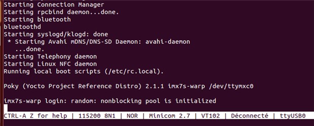

    Hello,
    Someone could tell me how to access in u-boot mode on minicom
    I can not mount the eMMC partition in mass-storage mode.
