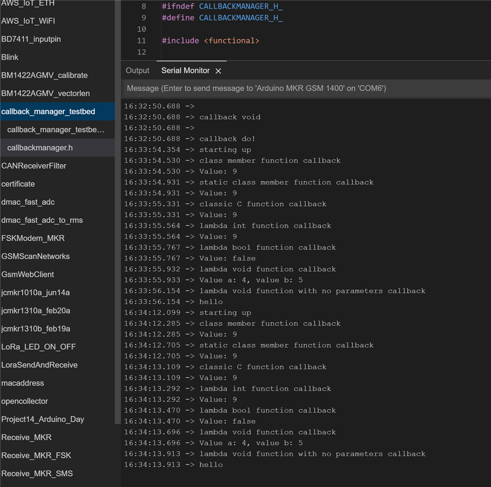

this library now also works for Arduino (tested with IDE2, and an Arduino MKT GSM 1400)
For Arduino, you can download callbackmanager.h to your computer, then use Sketch -> Add File ... to get the callbackmanager included to your project.
Add this line to your sketch:
#include "callbackmanager.h"
I added a sketch to test the callback manager to this gist: test_arduino.ino

    Jan Cumps over 2 years ago
    I added a sketch to test the callback manager as a GitHub GIST: test_arduino.ino
    I expect this will work on the newer ADO boards. The AVR compiler for Arduino UNO / Nano (both use avr-gcc) does not support this. But the Nano IoT (uses arm-gcc) does.
    A Zero and the MKR family work.

    Jan Cumps over 1 year ago in reply to Jan Cumps
    Just checked it on an Arduino MKR 1400, with some hardware manipulation. The callbacks do the job.
    Until your Arduino Board Manager ships with GCC 10 or later, comment this line in the callbackmanager class definition:
    //  requires std::is_void<R>::value || std::is_arithmetic_v<R>
    This isn't supported in the (at the time of writing) version that ships with the MKR boards. The code isn't needed to operate. It's a compile time construct that gives a clear error when you try to set a callback handler that isn't supported*.
    Without this line, you 'll get a compile error too, but it will throw that error at a location where it's not very clear what's wrong.
    So: result is the same: compiler throws an error as it should. But that extra line makes it easier to find what's wrong and remediate.
