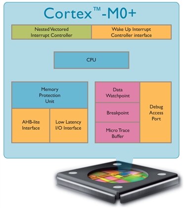

The ARM CortexTm-M0+ processor is the most energy efficient ARM processor available. It builds on the very successful Cortex-M0 processor, retaining full instruction set and tool compatibility, while further reducing energy consumption and increasing performance. Along with the Cortex-M0 processor, the exceptionally small silicon area, low power and minimal code footprint of these processors enable developers to achieve 32-bit performance at an 8-bit price point, bypassing the step to 16-bit devices. The Cortex-M0+ processor comes with a wide selection of options to provide flexible development.image
An optimized architecture with a core pipeline of just two stages, enables the Cortex-M0+ processor to achieve a power consumption of just 11.2uW/MHz (90LP process, minimal configuration), while raising the performance to 1.77 CoreMark/MHz.
