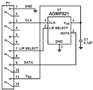

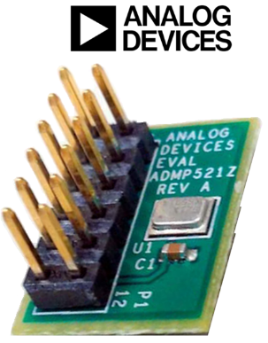

The Analog Devices EVAL-ADMP521ZEVAL-ADMP521Z is a simple evaluation board that allows quick evaluation of the performance of the ADMP521ADMP521 bottom port, digital output, omnidirectional microphone. The EVAL-ADMP521Z has a dual-row, 12-pin, 0.1-inch spaced header for access to all microphone pins. All signals are connected to the row of pins along the edge of the board. The pins on the inner row are not connected to any signals.
The EVAL-ADMP521ZEVAL-ADMP521Z is designed to plug directly into either row of Connector J6 on the Analog Devices, Inc., EVAL-ADAU1761ZEVAL-ADAU1761Z evaluation board. When these two boards are connected, the EVAL-ADMP521Z board should extend off the left edge of the EVAL-ADAU1761ZEVAL-ADAU1761Z board. The dimensions of the EVAL-ADMP521ZEVAL-ADMP521Z are 13 mm × 18 mm.
The ADMP521ADMP521 is a high performance, ultra low noise, low power, digital output bottom-ported omnidirectional MEMS microphone. The ADMP521 consists of a MEMS microphone element and an impedance converter amplifier followed by a fourth-order Σ-Δ modulator. The digital interface allows for the pulse density modulated (PDM) output of two microphones to be time-multiplexed on a single data line using a single clock. The ADMP521 is function- and pin-compatible with the ADMP421 microphone, providing an easy upgrade path.
