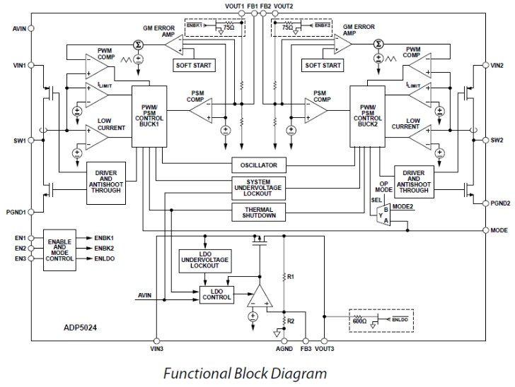

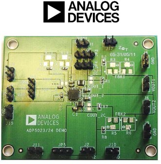

The Analog Devices ADP5024CP-EVALZADP5024CP-EVALZ evaluation board provides an easy way to evaluate the ADP5024ADP5024 device.The ADP5024 combines two high performance buck regulators and one low dropout (LDO) regulator in a small package to meet demanding performance and board space requirements.
The high switching frequency of the buck regulators enables tiny multilayer external components and minimizes the board space. When the MODE pin is set high, the buck regulators operate in forced PWM mode. When the MODE pin is set low, the buck regulators operate in PWM mode when the load current is above a predefined threshold. When the load current falls below a pre-defined threshold, the regulator operates in power save mode (PSM), improving the light load efficiency.
The two bucks operate out of phase to reduce the input capacitor requirement. The low quiescent current, low dropout voltage, and wide input voltage range of the LDO extends the battery life of portable devices. The ADP5024ADP5024 LDO maintains power supply rejection greater than 60 dB for frequencies as high as 10 kHz while operating with a low headroom voltage.Regulators in the ADP5024 are activated though dedicated enable pins. The default output voltages can be either externally set in the adjustable version or factory programmable to a wide range of preset values in the fixed voltage version.

Kit Features
Features of ADP5024CP-EVALZADP5024CP-EVALZ:
  • Full-featured evaluation board for the ADP5024ADP5024
  • Standalone capability
  • Simple device measurements, including line and load regulation, demonstrable with
    • A single voltage supply
    • A voltmeter
    • An ammeter
    • Load resistors
  • Easy access to external components
  • Cascading options to supply the low dropout (LDO) from either buck
  • Dedicated enable option for each channel
  • Mode option to change bucks from PFM to PWM operation
