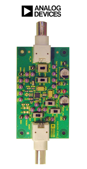

The AD8436AD8436 evaluation board (AD8436-EVALZAD8436-EVALZ) is fully assembled, tested and ready to use after the power and signal sources are connected. The AD8436-EVALZ offers many options, without sacrificing simplicity. The board is tested and shipped with a 10 μF averaging capacitor (CAVG), 3.3 μF low-pass filter capacitor (C8) and a 0.1 μF (COPT) capacitor to optimize crest factor performance.
The AD8436AD8436 is a translinear precision, low power, true rms-to-dc converter loaded with options. It computes a precise dc equivalent of the rms value of ac wave-forms, including complex patterns such as those generated by switch mode power supplies and triacs. Its accuracy spans a wide range of input levels  and temperatures. The ensured accuracy of ≤±0.5% and ≤10 μV output offset result from the latest Analog Devices, Inc., technology. The crest factor error is <0.5% for CF values between 1 and 10.
The AD8436AD8436 delivers true rms results at less cost than misleading peak, averaging, or digital solutions. On-board buffer amplifiers enable the widest range of options for any rms-to-dc converter available, regardless of cost. The built-in high impedance FET buffer provides an interface for external attenuators, frequency compensation, or driving low impedance loads. The low power, precision input buffer makes the AD8436AD8436 attractive for use in portable multimeters and other battery-powered applications.

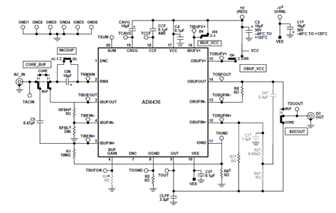

All the I/Os in the AD8436-EVALZAD8436-EVALZ board are provided with test points for easy monitoring with test equipment. The input buffer gain default is unity; for 2x gain, install a 0603 0 Ω resistor at Position R5. For higher IBUF gains, remove the 0 Ω resistor at Position RFBH (there is an internal 10 kΩ resistor from the OBUF_OUT to IBUFIN−) and install a smaller value resistor in Position RFBL. A 100 Ω resistor establishes a gain of 100×. Single supply operation requires removal of Resistor R6 and installing a 0.1 μF capacitor in the same position for noise decoupling.
