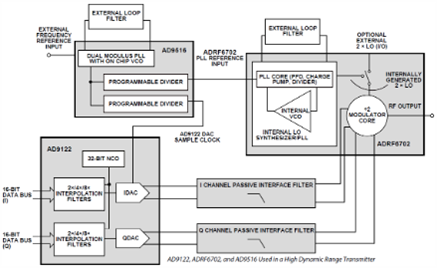

The combination of the ADRF6702ADRF6702 IQ modulator and the AD9122AD9122 16-bit dual 1.2 GSPS TxDAC has the dynamic range necessary for a modern high level QAM or OFDM based wireless transmitter. The dynamic range of this circuit (EVAL-CN0243-EB1ZEVAL-CN0243-EB1Z) is good enough to enable both ZIF (zero IF/ baseband) and CIF (complex IF up to 200 MHz to 300 MHz). The AD9122 has the option of up to 8× interpolation, as well as a 32-bit NCO for very fine IF frequency selectivity.
The ADRF6702ADRF6702 includes an on-board fractional PLL for LO generation so that a low frequency reference (typically less than 100 MHz) is all that is necessary to synthesize the IQ modulator LO. Using the PLL in the AD9516-4BCPZAD9516-4BCPZ clock generator allows a single reference to generate both the DAC sample clock and the PLL reference for the ADRF6702.
The circuit was built using the AD9516-0AD9516-0, but other members of the AD9516-4BCPZAD9516-4BCPZ family could be used depending on the desired internal VCO frequency.
The ADRF6702ADRF6702 IQ modulator is a unique device in several respects. In addition to its exceptional dynamic range, it also includes a fractional-N PLL, which allows programming of discrete LO frequency steps of less than 25 kHz while at the same time keeping the overall frequency multiplication small enough to avoid a large increase in phase noise from the reference to the synthesizer output.

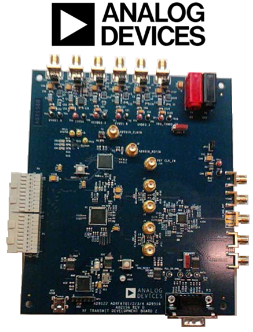

Kit Contents
The Analog Devices EVAL-CN0243-EB1ZEVAL-CN0243-EB1Z is supplied with below contents:
  • Evaluation Board
